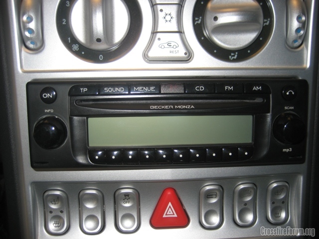

I purchased a Becker 7885 on Ebay Germany... Black face - Blue display...
I discovered that if any Becker or Blaupunkt head unit that will control a Becker 2660 or compatible CD changer - then there are so many options for adapting an iPod or iPhone to the unit.. This is also true for the factory NAV HU - but my SRT6 was not equipped with Factory Nav - nor did I want to buy one.
So - I swaped the face plate from my stock silver HU with the one shown above (way to easy) and unsoldered the blue LED's behind the display and replaced with the green LED's from my factory unit (a lot more work) but other then that and an antenna adapter it was plug and play.
Now I have 4 channel sound Socket B - (with additional amp and wires) - and much more dynamic range and control (the bass is incredible) I hooked up an iPad/iPhone adapter to the CD Changer socket C2 & C3 for under $125 that I can control from the H/U and keeps my iPhone charged -
I now have phone input, Socket C3 and mute on Socket A, for my bluetooth device for handsfree calling that I hear thru the speakers... 5 channel pre-amp output (socket C1), (front, rear, sub-woofer) Traffic info, RDS, MP3, GAL, SW radio, Track display (song, artist) from the CD Rom, etc...
And it looks so factory...... Perhaps I should do a full write up..

Great job and I have to ask a question of you. Can I change the face plate from my non Nav Becker to my Nav Becker. Presumably the answer is yes. My non Nav faceplate is unmarked and the other has a few scratches. I'm assuming the black blank plug can be removed and have the button replace it.
I looked and after being told it was a risky operation I dropped the idea.
I have the 2660 CD changer and would like to add the phone option to the system eventually, that can be done according to the write ups but I did not find any parts to enable it to be done.
How do you get the face plate off?
So do the write up and let us all learn from your endeavors - please.
Yes, with a little patience you can "swap" the plastic covers, the ***** and buttons between the radios.
You can't swap the display or the electronics as they are different and model specific.
No - you need a complete new radio model for that, which means you will loose Nav but gain the other functions.
Remove the radio from the car. Remove the top cover - it just slides up.
You will see two small torqs screws. Remove them and the rest is all plastic clips (bottom and sides). Just be careful and patient and don't damage the display or electronics.
Good Luck.

I just wanted to personally thank Brian (BrianBrave) for all his help in my quest to duplicate his install. Thanks to Brain it was relatively painless.... and felt his hard work shouldn't go unnoticed.
And for those of you who need a little help swapping the face plates here's the D.I.Y. Brian sent me:
Took my old radio apart to take some pictures and remember how I did it.
First, remove the 4 small torq screws on the back
Second, carefully twist the small tabs on the bottom so they are straight.
Make sure the two large ***** on the front of the unit (volume and tune) are removed, then simply (but carefully) pull the face plate off.
There are two tabs on each side that you will need to slide of the keepers....
In the next picture you will see two long snap-in guides that fit/snap into the PC board.
(This was the hard part for me as they were pretty snug and you need only pry gently near them to get the faceplate separated from the back.)
Carefully pulling on the faceplate while holding the PC board (after sliding the side keepers off) will remove the faceplate from the circuit board.
Re-assemble in reverse order with the silver faceplate and *****, noting that there is soft recoil plastic (the white guy in picture #3) between the top row of buttons on the faceplate and the switches on the PCB that will need to be alighned - But you will see that.
