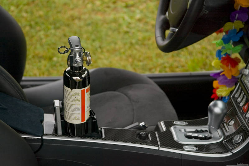

Putting a CD player in the trunk left me without a space for the small fire extinguisher I always carried.
So I mounted the extinguisher bracket on a piece of wood, painted it black (the fastest color) and added some Velcro hook strips to the bottom.
It does not move around and the weight is enough to get a good grip.
It does the trick so I think I'll give another couple of coats of paint and round off the edges.

You could have just used your cupholder:
That's a good point, but in a fire maybe that's the first thing I would want to see burnt.
