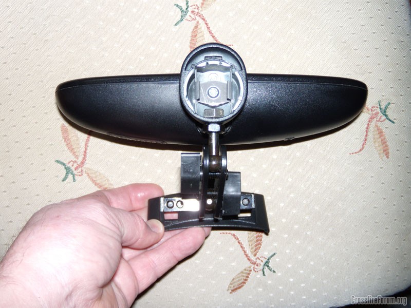

Steve(32krazy) found this neat little mount that says it is for the Crossfire..... I looked at how it mounted and thought... that won't work on a Crossfire. But it did give me an excellent starting point so I bought one.
NEW VALENTINE ONE V1 RADAR LASER DETECTOR BRACKET MIRROR MOUNT | eBay
I got it on Tuesday and as I expected the clamp for the mirror mount was useless. But in taking the mirror off I found out you need to use a 5mm rod(or equivalent) and stick it in the hole on the back side of the mount and twist 90 degrees and the mirror falls off. Now the coincidentally cool thing about that is that the threaded ball stud on the clamp is a 1/4-20 thread. 5mm = ~0.20".... so I took a 1/4-20 tap and threaded the 5mm hole on the mirror mount...then I screwed the ball stud into the mirror mount and set the jam nut... seemed pretty secure but I added a nut inside the mirror mount to give it more to hold onto...
I also found that the link on the bracket is a little short and you can not adjust the V1 under the mirror correctly so it is flat and clears the little dimmer switch on the bottom of the mirror..... So I milled up a little spacer to go between the V1 bracket and the new bracket... aaahhhhh just right! A little black paint and a couple of button head screws and it should be perfect....

I was staring at the side view pic and realized that I could have just made the spacer taller, drilled a 1/4-20 hole for the ball stud on that end and not use any extra screws. Still new some black paint though...
I could make more of these.......

My Christmas present had me searching the site for install ideas. Didn't care a whole lot for the suction cup to the windshield off the side of the mirror, but the thread did show removing the mirror. I realized that hole could probably be tapped and used to mount a bracket. I like the nut to the inside as a safety. My only concern was with the autodimming mirror, a bracket hanging down would be in front of the eye. It's hardwired into the homelink system now and suction cupped to where it hangs just below the mirror for the rear detection ability. Didn't get the v1 for Christmas.. it's a Cobra model (yeah I know..let the hating begin..lol)..but it works good enough when my route is consistant and I know where it shouldn't be going off.
Nice to see my thoughts on using that hole confirmed!

Not intending to hijack the thread here, but this is the first thread I've seen regarding the Valentine 1 (and its mounting), so I thought I would add some pics of an alternative crossfire/slk-specific mounting arrangement.
I think that this mount Steve found (and then MikeR made work) is super cool (and an awesome value) .... I just don't like things hanging from the rearview ... that's just me (since I often watch the road/track through the windshield of the guy in front of me, I am sensitive to this issue)
Also, if you use the remote display for your valentine, you don't necessarily need the receiver right in your face anyway.
This install did require that I cut-down (shorten) the passenger visor, but I feel that with the V1 tucked up and out of the way, it is less likely to invite a sticky fingered passer-by to reach into the car ... so it was worth sacrificing a visor (I had a spare : ).
Still left to add is a cover (to the rear) made out of some Perspex 962 (black, yet transparent to infrared light (at least at 904 Nm where laser operates)) leftover from a hidden laserjammer install.
NOTE alternative TENNIS BALL placement as well (pic 3) .... I like to back in and the ball positioned thusly aligns both my X and Z axes : )
