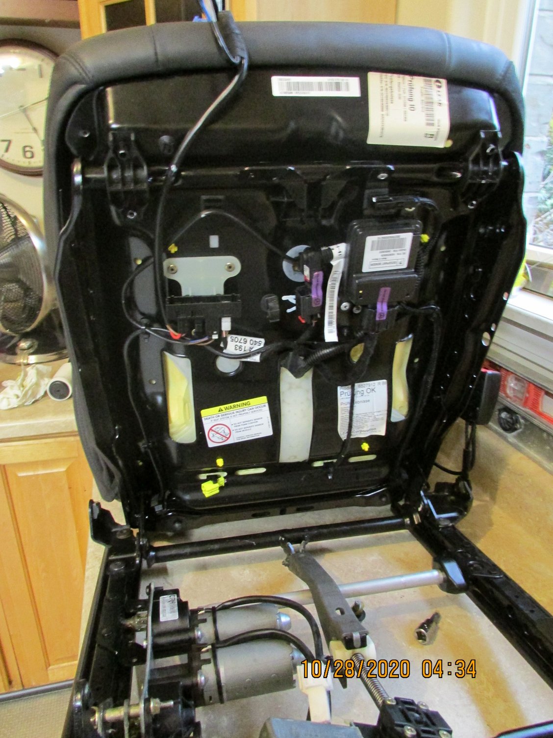

I bought a right 04 slk seat rail from Ebay to install on my 07 limited roadster passenger side and started the switch process. Thanks to Red Runner and Lag Dan for all the time and effort put into the instructions and photos . The problem i'm having is there looks to be other equipment on the bottom of my seat, a occupant sensor system with the purple tags is in the way of connecting the new seat rail. I can't attach the screw drive and motor because it won't clear those parts. Is my 2007 not compatiable with slk seat rail ? Thanks for any help Dcskmail

Thanks John, The problem for me is my car is an 07. They made changes to the bottom of the seat adding a occupant sensor system which is directly in the way of the screw drive and motor.

The passenger's seat also has the system . You can see it in the photo at the top of this page. It's my passenger seat, the parts with the purple tags on them is the system .
I understand the passenger seat has the occupancy sensor. But isn't it unlikely the driver's side would have an occupancy sensor? I am trying to say it might not help you because for sure the passenger side has it but the driver side has no reason to have an occupancy sensor for the airbag. Make sense now? Just trying to save you from extra work by removing the driver's seat.
