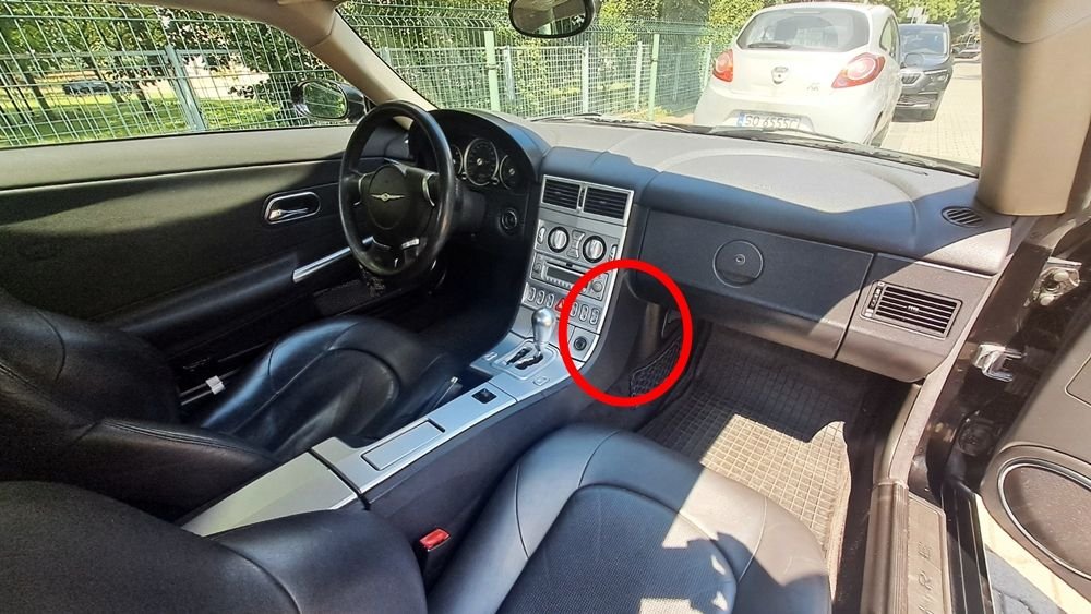

@M60A3Driver No, the passenger footwell carpet wasn't wet. When I bought the car, I immediately bought rubber mats.
In the photo below, I've marked in red where the strange noises are coming from - in my opinion.
I briefly visited an auto electrician's workshop, who initially determined that there were various air conditioning flaps in that area, and that those might be the problem.
The electrician said he'd have to disassemble the center console and check.

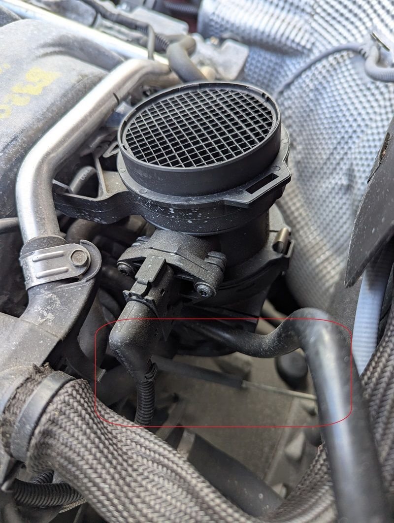

You might want to check the vacuum line from the intake manifold to the AC. Make sure it's not leaking as that could cause the flaps to behave erratically.
vacuum line marked in red under the mass air flow sensor

There are no "Air Conditioning flaps" in that area - you are falling for an acoustic trick, the sound most of us here comes from behind the glove box cavity.
You might read thru this:
https://www.crossfireforum.org/forum...artment-2.html
And I'd pull the battery out and look at the condition of the vacuum line you were previously told about.

There is another vacuum line that runs under the battery too. The HVAC module has two *****. The fan speed **** controls power to the fan and that has been known to fail including the fan resister. The second **** has a mechanical linkage to a valve that controls the damper flaps.
