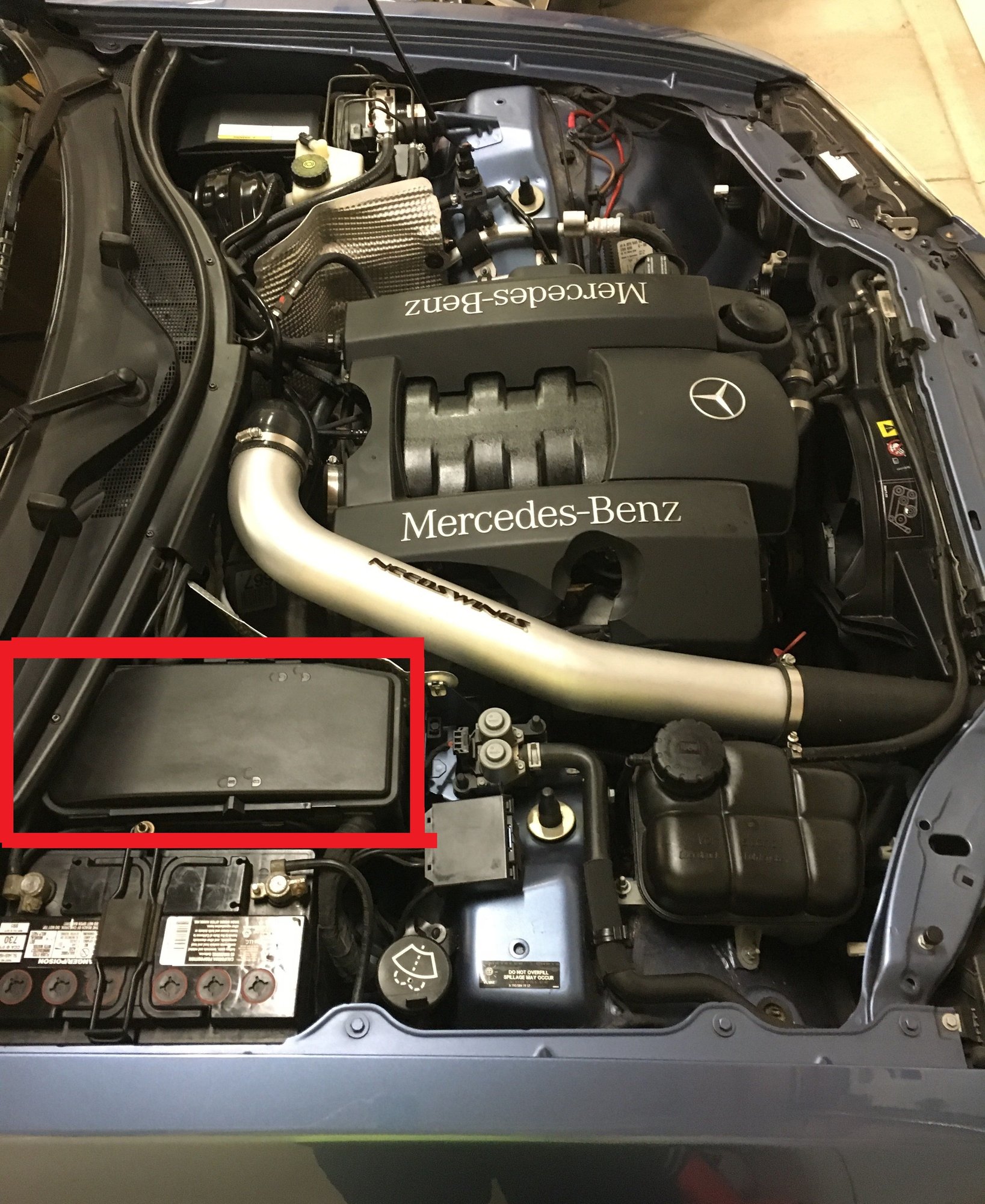

Thanks I believe in these forums. My father joined this one too but forgot his password told him how to retrieve it but I know my dad that’s why I joined to get help. Anyways I agree with the dealer thing they don’t know. I appreciate the help, where is the ECM is that the circuit card I removed and soldered already? It has some fuses on it.
Old Apr 10, 2019 | 08:41 PM
Posts: 18,136
Likes: 1,629
Default Re: 2005 not starting
The RCM is inside this box highlighted in RED
You can order a NEW RCM from fcpeuro (link below)
Most of us carry a new spare just in case ours fails
https://www.fcpeuro.com/products/mer...lay-1705450305
