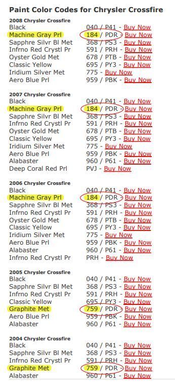

Where' the paint code located. Is it included in the VIN number?
yes. It's on the VIN sticker on the inside of the driver's door. It's a 3 letter code at the bottom of the sticker, toward the left lower corner.

I think this may be mis-information, I KNOW the paint code is NOT included in the VIN number, and I am pretty sure the paint code is on the rear of the body, you have to remove the rear bumper cover to see it.

Default Re: (1st Post) Bought 2007 Crossfire

When I bought the car I was told it was a Machine Grey which I don't see on the above list.
The above list is for the 2005 models, machine grey was introduced in 2006
Old Nov 24, 2020 | 01:17 PM
  #120 (permalink)
Posts: 8,489
Likes: 855
The codes above are actually the Sales Codes for the respective Crossfire colors listed. These get used interchangeably with the Color (Paint) Codes which are different & unique.
To distinguish between Graphite & Machine Gray here are the respective codes:
Graphite Gray: Sales Code = PDR; Paint Code = ZDR (Alternate Color Code = PDR/759)
Machine Gray: Sales Code = PDR; Paint Code = DDR (Alternate Color Code = PDR/184)
If you use the PDR code, you will have to include the tint code (3 digit number) to distinguish between the 2 gray colors. That 3 digit number means something to a reputable paint shop.
