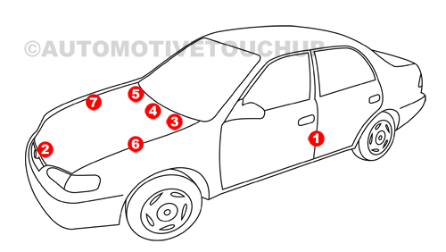

I can't find a paint code anywhere so I can order paint touch of pen. The picture is were the codes are "supposed" to be located but I don't see one. Anyone know? I was told by the owner that it was Machine Grey but need to order by paint code on the car.
I read somewhere that the code is behind the rear license plate. I have never looked though.

Machine Gray Paint Codes, for your reference. See attached files.
Be sure to give the tint combo (184). You will notice that Chrysler used the same Sales Code (PDR) for the Graphite Gray & Machine Gray. If you use that Code to purchase a paint pen, you will need to also provide the tint combo (184) to get the proper color. Some paint shops know the difference between the 2 colors; some paint shops DO NOT! I get my touch-up paint pens from Automotive Touchup. They will know the difference between the two grays. Just make sure you say what model year your car is.
Still like to find the paint code that's on the car to make sure I order the correct color. Tomorrow I'll look again more closely. Thanks for the info.
