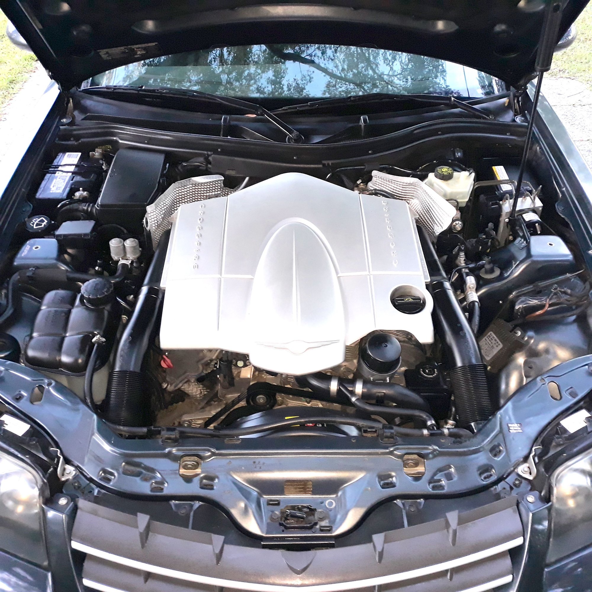

Busy day cleaning the engine bay. Came out pretty good! After degreasing/cleaning I used "Black on Black" on all the plastic and make it all look new again. After spraying I buffed all the various parts to give them a better appearance than shiney!
