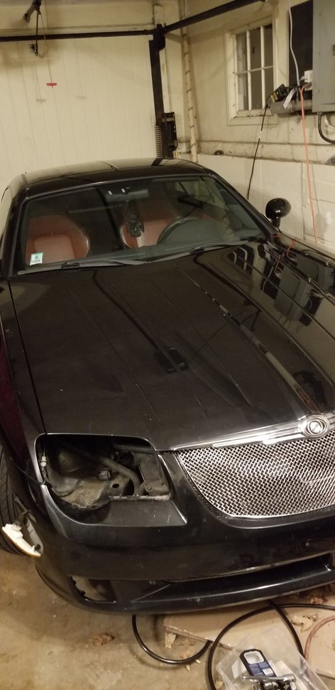

So the previous owner did not take very good care of her the main problems are with the electrical aspects of the car, heated/power seats don't work, dash gauge back lights are out and my biggest concern is with the blower fan, I just got a power module by the blower for it and installed it today (previous owner said that it was blown). After installing it the fans came on and the heat worked fine, then it just decided to shut off, while it was running the dial wouldn't change the speed of the fans. After about 5 minutes the fans turned off and stayed off. It's very frustrating

Looks like you'll need a right hand headlight assembly . Prices are terrible , the only thing available is used. If your interested they're asking $300 Abco Auto Parts USA-TX(Hearne) 979-279-6001 / 979-279-6000

My new headlight assembly finally arrived and I installed it! Turns out the dash light problem was because the previous wired some sort of switch onto the fuse board inside the dash. God only knows why. But I took it out and replaced the fuse and they lit right up! Now just to fix the fans and she'll be good as new!
