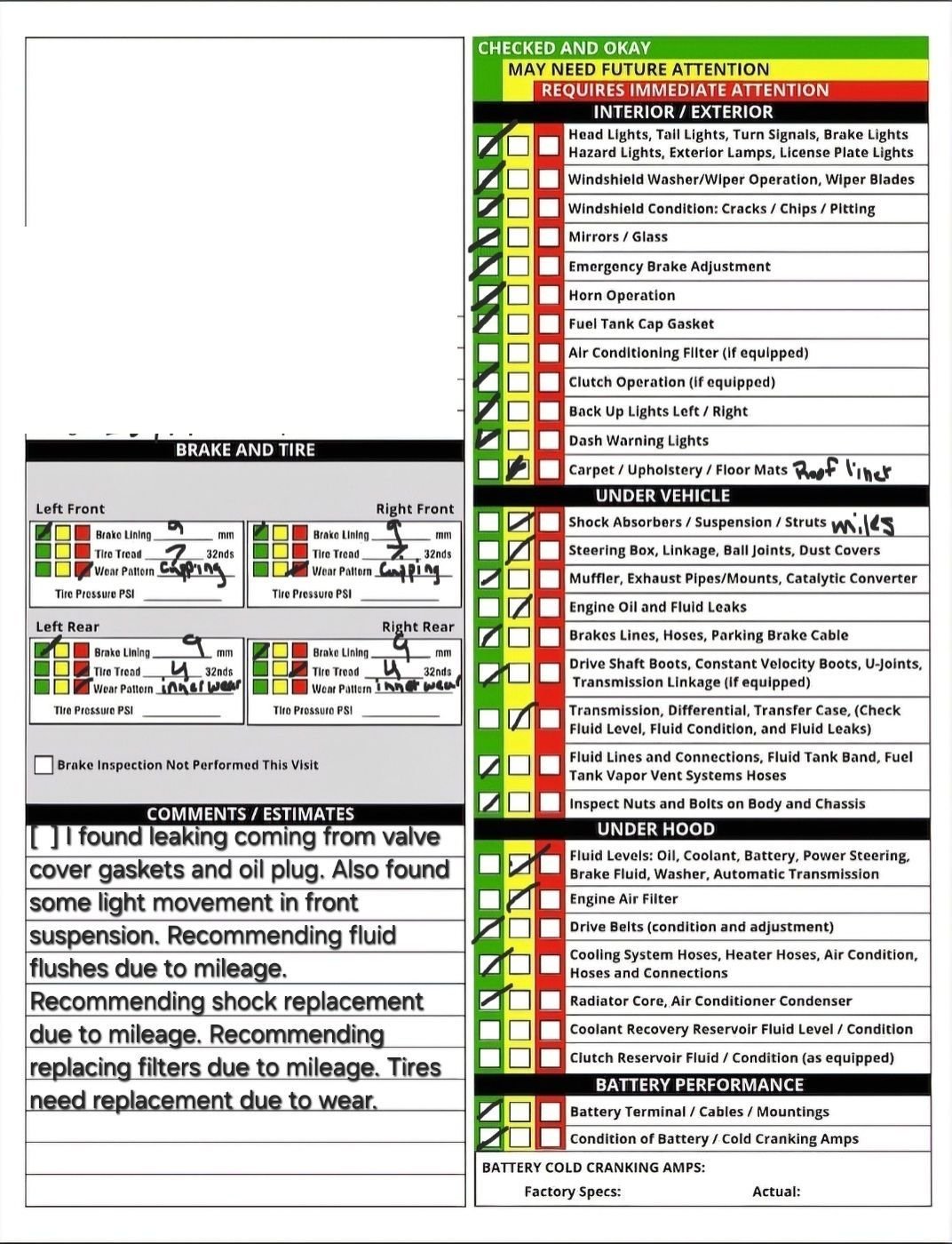

Here's the mechanic's report.

Pretty normal stuff for a twenty-year old car. I would not hesitate if you can get it for the price you want.

Almost all of the items on there are maintenance items that need to be done anyway.
As far as the steering, you might just need a new steering damper/stabilizer. If you replace it get a Bilstein. It's a few bucks more but well worth it. Steering Damper/ Stabilizer
Search for parts as an Mercedes-Benz SLK 320. I like FCPEuro because shipping is free after $49.00 and they offer a lifetime warranty on almost every part they sell.
