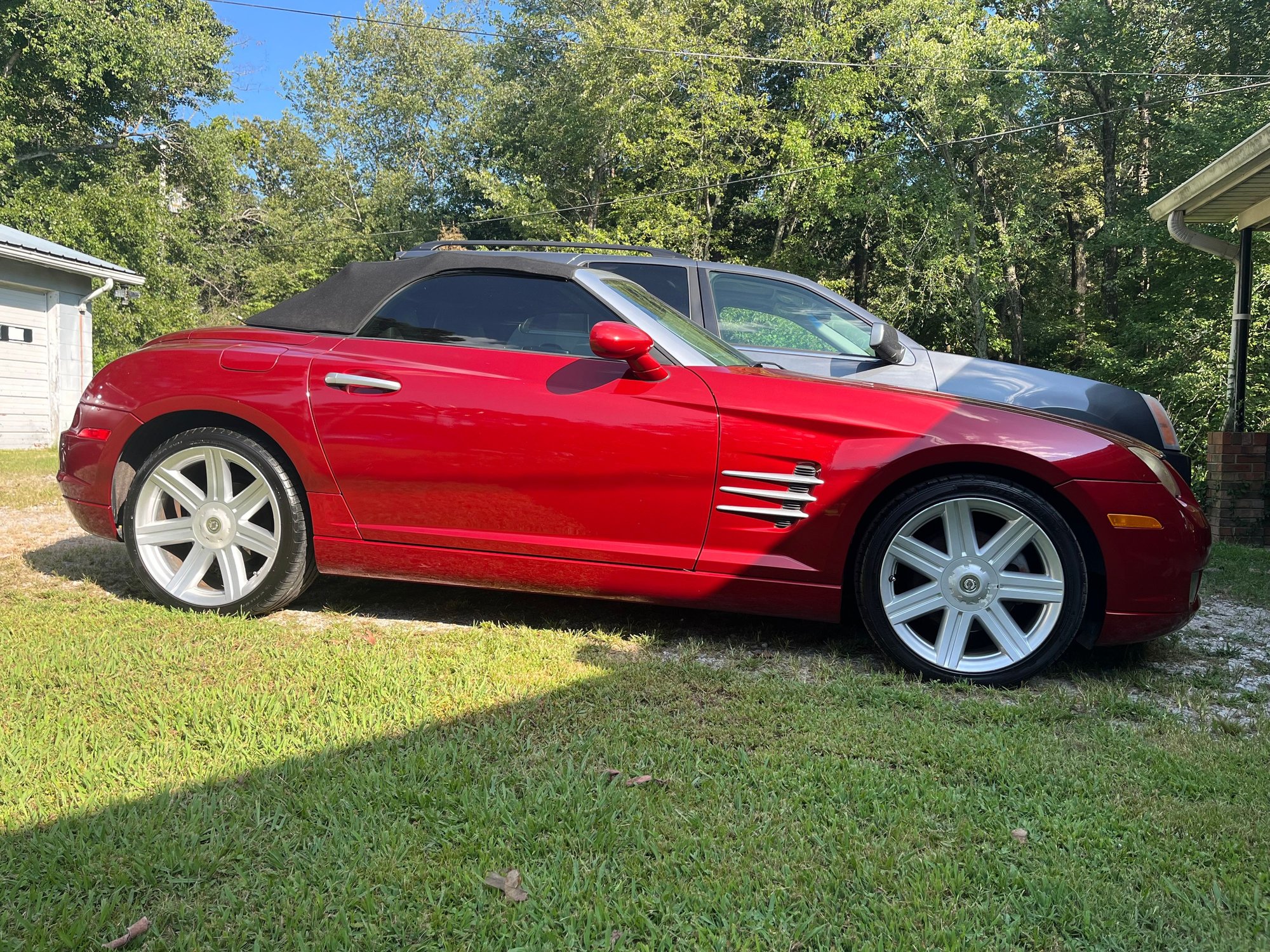

Good afternoon. New member as of today to try and learn more about this neat little car. I’ve inherited a 05 Crossfire Base convertible in the Blaze Red color. It has 83K miles on it. It’s a very clean little car. Well, now it is. It had been sitting for two years.
I’m still trying to decide on keeping the car or putting it up for sale.
The convertible top does not retract with the push of the button and the rear spoiler doesn’t engage either with the button. I know they both once worked. I’ve looked at everything to see about corrosion or chewing of wires. I see no issues. I don’t hear the tops motor trying to engage at all. These two issues have me thinking it may not be worth the trouble.
So, I’m here to learn about what could be the issues and go from there. I will be searching and reading a lot.
