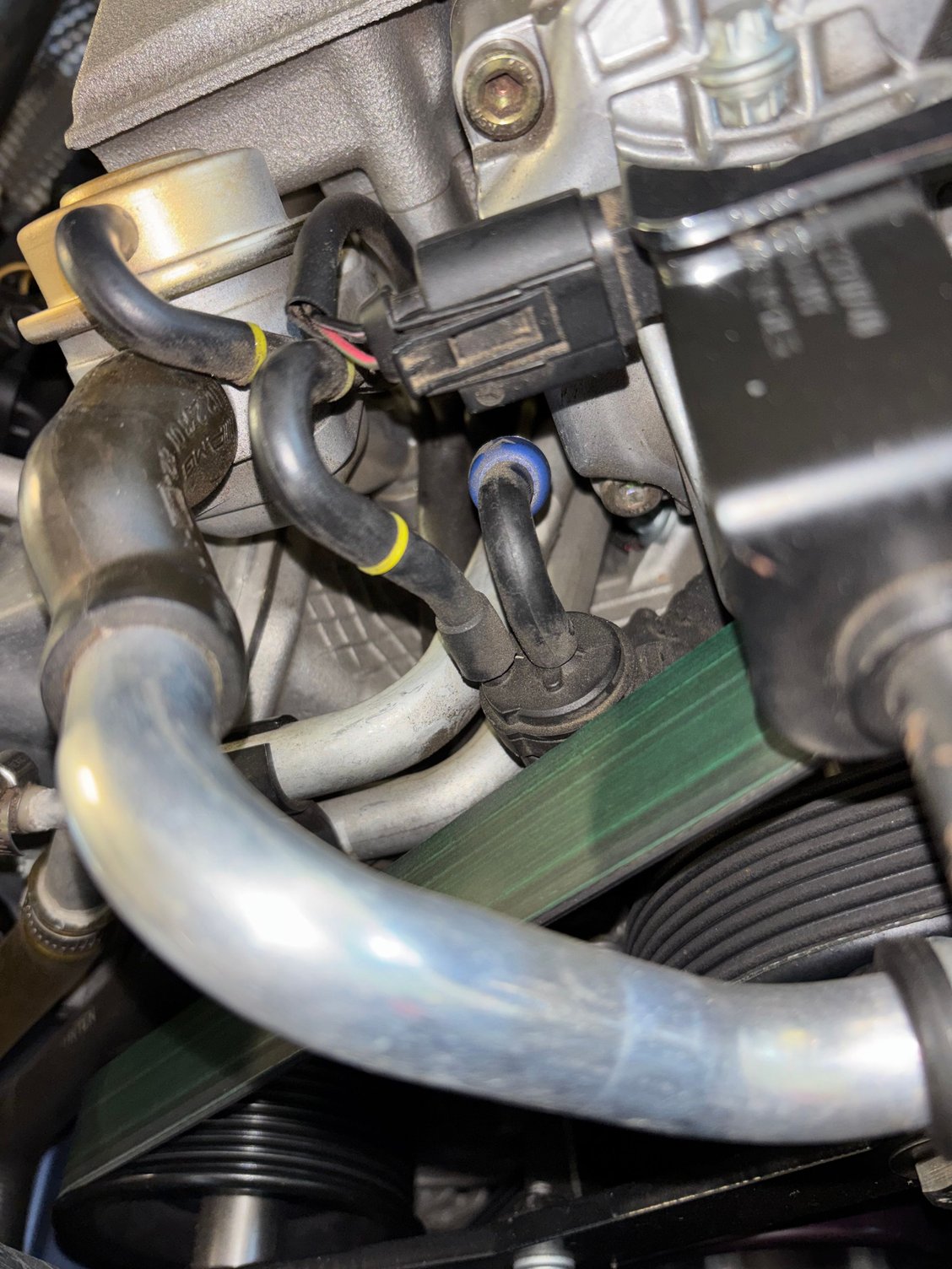

I do have a 2005 crossfire srt6. The air pump is running at cold start. The results from the live data on the o2 sensors is as follows: (when pump is running)
O2 s1 (passenger side) .090 - .750volts
O2 s2 (drivers side) .465 - .470volts
By the way I live in Goodyear Arizona.
Please let me know what you think.
thanks,
Normt18101

Okay I believe those numbers look normal, but the drivers side is a bit higher than it should be in closed loop and cold startup. It may indicate there is a problem with the drivers side. You should have a low voltage with a lean condition. Lean should be about .2 volts and rich is up about .6 to .9 volts. The air pump will run while the engine is warming up, probably not much over one minute and then it should shut off. Does the air pump shut off ?
Thing is with O2 sensor numbers they fluctuate up and down quickly so it is hard to get a average voltage. When the air pump shuts off you hopefully will see about a 25% increase in the voltages. It's hard to tell.
The vacuum is fed to the solenoid valve blue inlet from the rear of the car through a clear vacuum line that runs to the rear of the car under the passenger fuel rail. The solenoid valve is controlled by the PTCM. There is another clear vacuum line that runs under the supercharger between the two switch over valves (The two gold colored large valves that the large hose and metal tubing connect to the air pump). It is easy to tell if the solenoid valve has vacuum and feeding the vacuum to the switch over valves at startup. Simply pull the vacuum line off the switch over valve and put your thumb over the end of the hose. In your situation I would pull the line off the driver's side switch over valve first. You can feel the vacuum when you remove your thumb from the hose. That vacuum should only be there when the air pump is running at the cold start up. So that will test the vacuum lines and the solenoid operation, but it doesn't tell you if the switch over valves are opening to allow the air pumps pressure into the exhaust system. That's what monitoring the O2 sensors can tell you, but as I said that's difficult to determine by just observing the O2 sensors output voltage.
Do you have any other DTC ?? Good Luck!

We need to use the same nomenclature or we'll get confused. A check valve is mechanical. The solenoid in the secondary air system is operated electrically You can see the electric connection at the bottom of the solenoid. Here is a picture:
See the blue collar. That is the vacuum inlet to the solenoid. When the solenoid opens (only at cold starts) it allows vacuum to the yellow collared lines which opens the switch over valves. The switch over valve, passenger side, is in the upper left of the picture and has a gold cap.
In a previous post I asked you to check the vacuum at the drivers side switch over valve by removing the vacuum hose and feeling the vacuum with your thumb. This is at a cold start up with the air pump running. Have you done that?? Do you have vacuum? When the air pump stops running the solenoid should close and thus the vacuum at the switch over valves should not be present. It is explained more in my posts above. Please go back and read my previous posts.
A driving cycle must be completed (some testing requires multiply cycles to be ready for testing). A driving cycle is not how far you drive, but how many times the car has gone through a start warm up and shut down cool off cycle. The EVAP system only works when the PTCM activates it under particular parameters.
