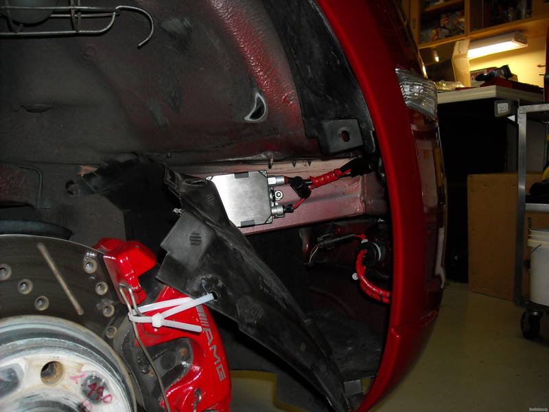

I was in you gallery and noticed this pic on you HID's. Is this an example of a rub spot from the tires in the front?

Getting pics is a PITA. One is in my gallery. Front. In the pics of the HID conversion.
Upper left. That is the drivers' side. The rub is at the far front, and only hits on full lock and hard braking.
That's what I was looking for. I couldn't find it! You were using it.
Damn! Oh-yep, that's it!

I am running 225/35/19 in the front with a similar rub as shown in the photo above. This is with the car being lowered. I have 285/30/20 in the rear and have a slight rub on the inside top of the wheel well. Each contact point can (and will) be eliminated with a few nice taps from a HAMMER!!!
