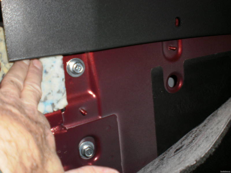

Heres a quick shot from my roll bar mod, I didnt pull the carpet back all the way though. The subs are right below in the pic and may be a concern when foam gets in back there. I honestly dont remember much about the black vinal sheet (shown in pic) didnt pull it back to get in there but it could be hollow
