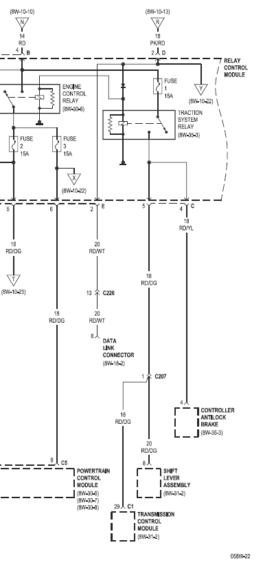

Since +12 only goes through F1, then the contacts on the traction system relay, I would have to think that the contacts have become welded in the closed position :
Thanks for the answer =) it would make sense yes based on the diagram. How could I check and/or fix that ?

You can check it by removing the cover on the RCM and just look at the relay contacts :
RCM relays
