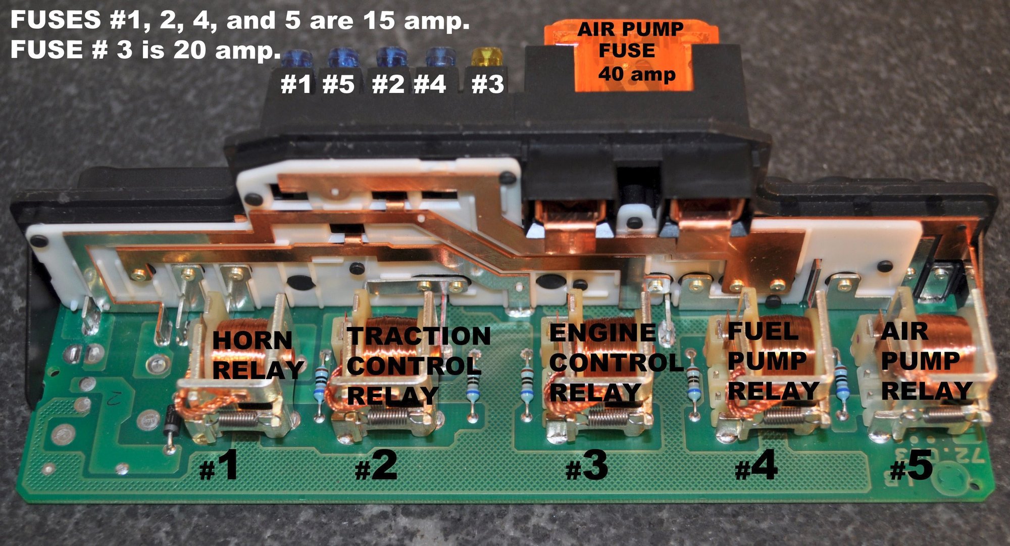

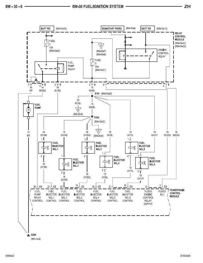

If there is no fuel at the port when the key is turned on, then check the engine relay and the fuel relay in the RCM to see if they are both being energized.
Also check the 3 joints on the back of the RCM as referenced in the "Mystery No Start" thread.
I'll put I'll put my money on the RCM
If the fuel relay is not energized have you aver manually pushed the contacts over to make contact. Just for Dx purposes.

NOTE: If the engine relay energizes, and the fuel relay does not, then you have an open coil on the fuel relay or fuse 3 is blown :

I did check the RCM and with the key on the engine control relay activated but the fuel pump relay did not. I manually activated it but still no fuel at the rail. I even tried the re-solder fix of the three contacts on the RCM. All fuses are good and there is power to and through all fuses. What do yo mean by an open coil?

That means that the wire that makes up the coil has a break in it, or is shorted out internally.. there are a lot of options on how to repair it and all of them can be found here on the form. The simple one though is to buy a new RCM install it and be done and on your way and send the old one to tighed1, he will refurbish it and send it back to you and then you can put it in the trunk for a spare.
