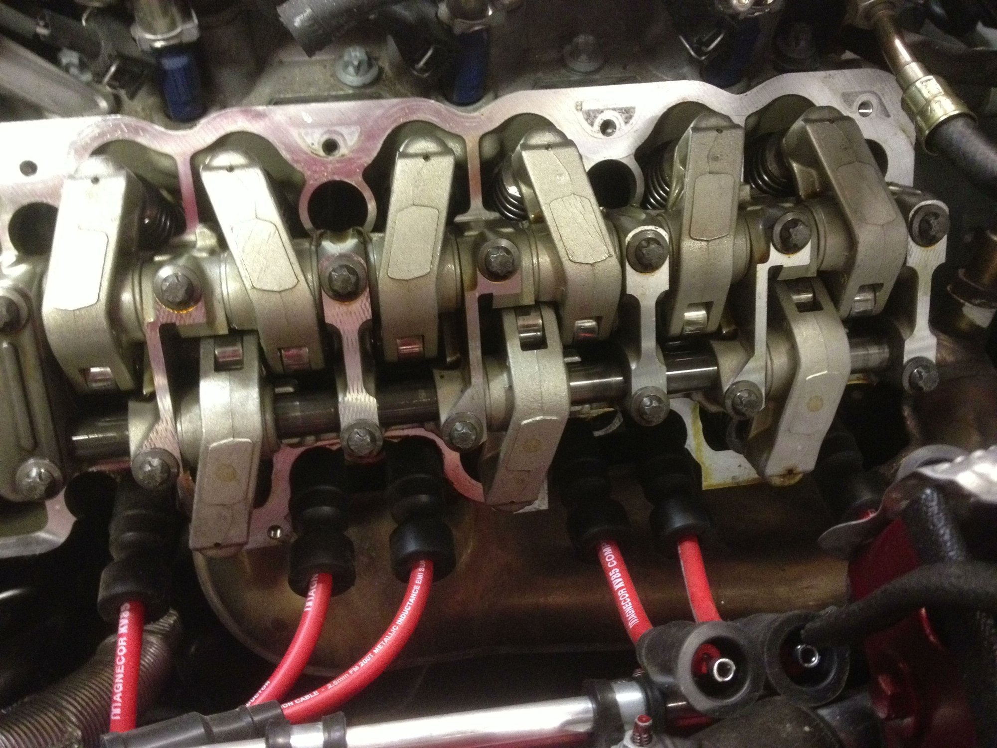

Changed oil and car sounds good. but after it warms up it will start to tick the ticking noise sounds like it is coming from valve cover area on one side and it is a light ticking noise {not a knock) and not coming from deep in engine. Gary
Old Dec 18, 2017 | 02:07 PM
Default Re: '05 crossfire
Most likely a partially collapsed lifter or obstructed oil passage.
The 'lifters' on these engines are in the end of the rocker arms where it contacts the valves.
driver side at 53,000 miles
Old Dec 18, 2017 | 03:38 PM

Old Dec 19, 2017 | 03:09 PM
Posts: 6,375
Likes: 811
That's a pretty (clean) engine there George!
Old Dec 19, 2017 | 04:26 PM
Yep, that was at 53K.
Looks the same now at 74K, LOVE the M1 0w40.
