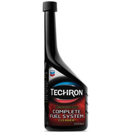

Mileage? New plugs @ 100K? You will probably get other "try this" suggestions.. but if it runs fine other than getting it started.. I'll suggest Chevron Techron "as directed" on the bottle.. 1/4 tank of fuel and add. Not impossible injectors leaking down and giving you the "flooded" sensation..
Its got 98,000 I’m going to have it looked at this week in the mean time I see 2 different treatments either “complete fuel system cleaner” or “fuel injector cleaner” which one should I use?
