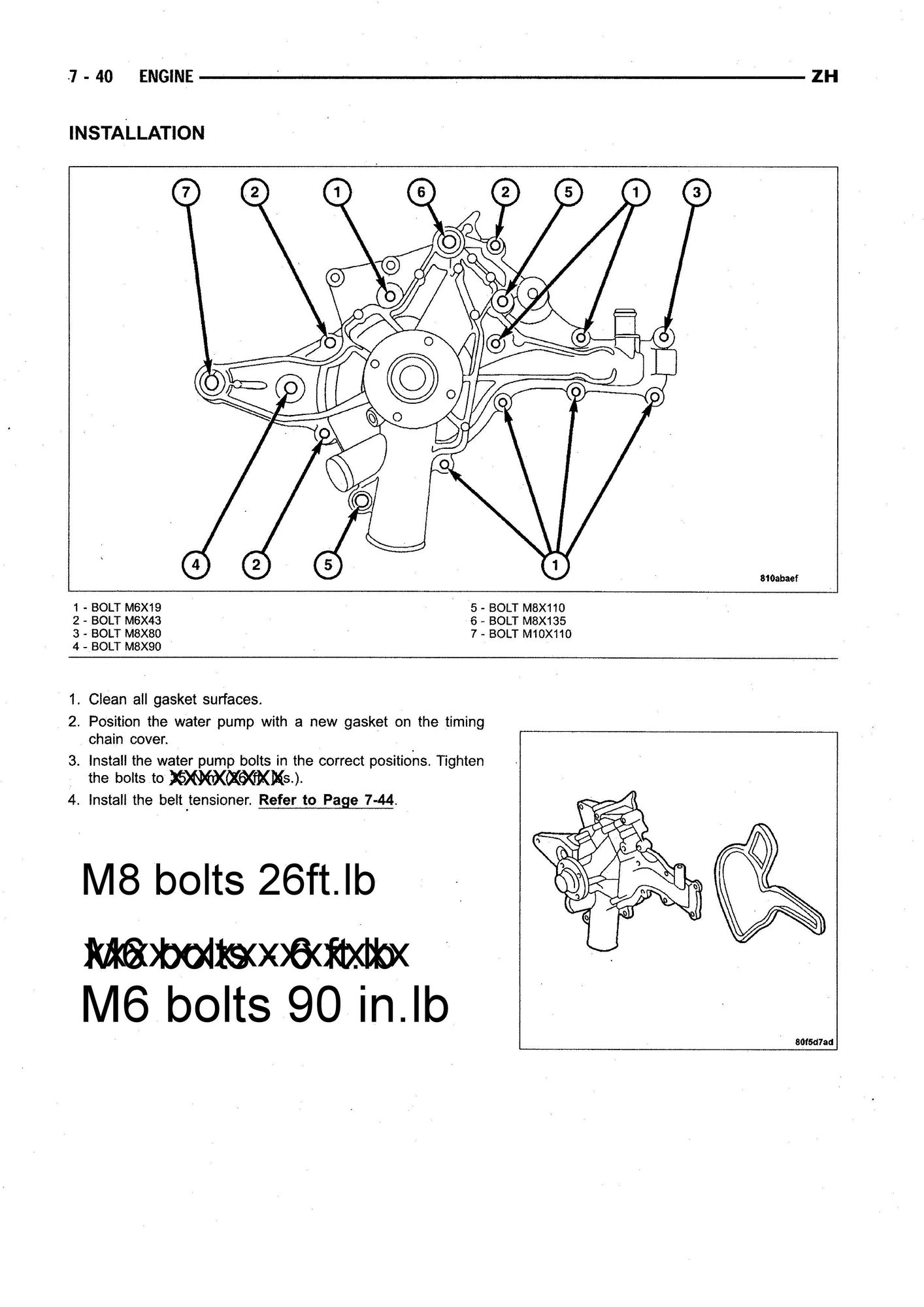

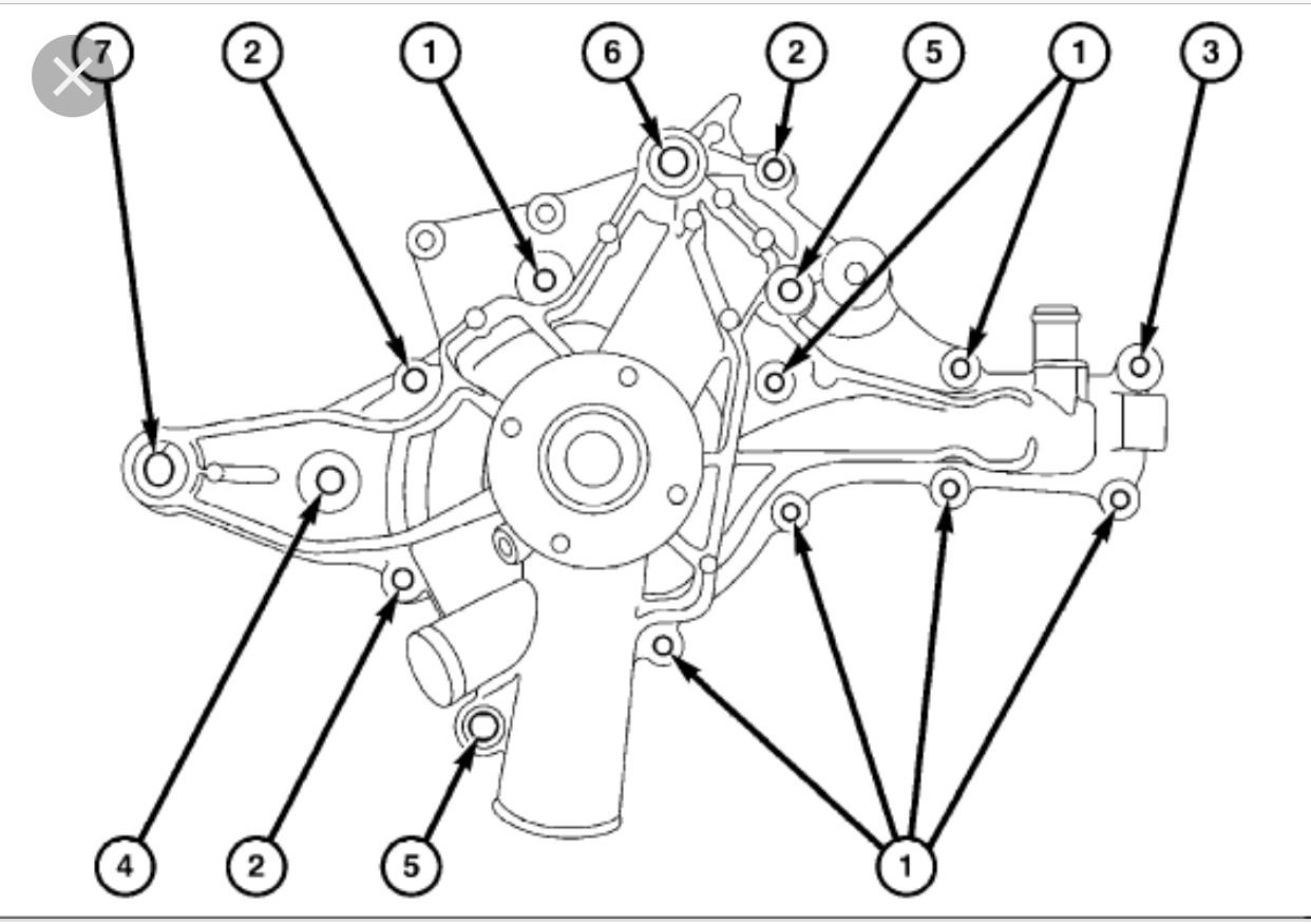

They are both the 1 type
Just replaced the water pump but sheered 2 of the smaller bolts in the process, any idea on where to buy these discontinued bolts

Default Re: Coolant leak only after the warmed up
These 2 specifically
The bolts were not discontinued, as they were not made especially for the car. They are available somewhere, you could use the same bolt but an Allen head instead. You should get a special plated type to avoid the steel corroding the aluminum alloy as it is in an exposed place for moisture and salt if driven in those conditions.

Dave, IIRC, did you post all the measurements of the various size bolts used for the water pump install? It may be a good idea to replace them all, or at least have them on hand when doing the job.
James
I did not but someone did I recall.
Mastermike added the list. I added the torque figures, the ones on the page did not reflect the torque setting for the 6mm bolts. No surprise that the OP sheared his bolts.

Look what I found.
Old Jun 16, 2019 | 10:54 PM
Likes: 651
Look what I found.
See my previous post, I updated it this afternoon.
No wonder the screws broke if the same torque was used on all screws.
