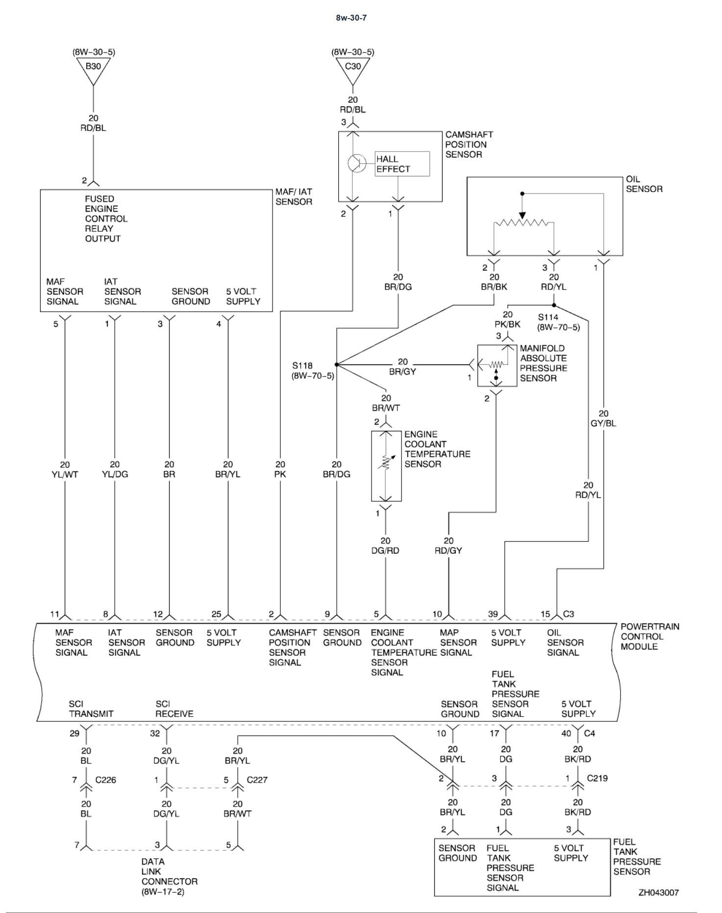

All those things seem to share a ground through the pcm if I am reading it right. cam, maf, oil lvl, map. So my current theory is that something is damaging my pcms but only a certain part like a driver or some such and not giving any codes specifically. It seems that the pcm is just not sending a start signal out. But I am at a loss exactly how to find the issue. As I am typing this, I wonder if i need to check the ground wire better. I checked that it was working as a ground, but not if there was voltage running through it? How would I check that best to see if it were putting too much through to the pcm? I didnt get any voltage on it probing directly(battery ground with com and sensor ground with positive lead but maybe thats not the right way to do that. Or any other ideas of what to look at?
I think i will need to get yet another pcm but I need to get the issue narrowed down before I just fry another.

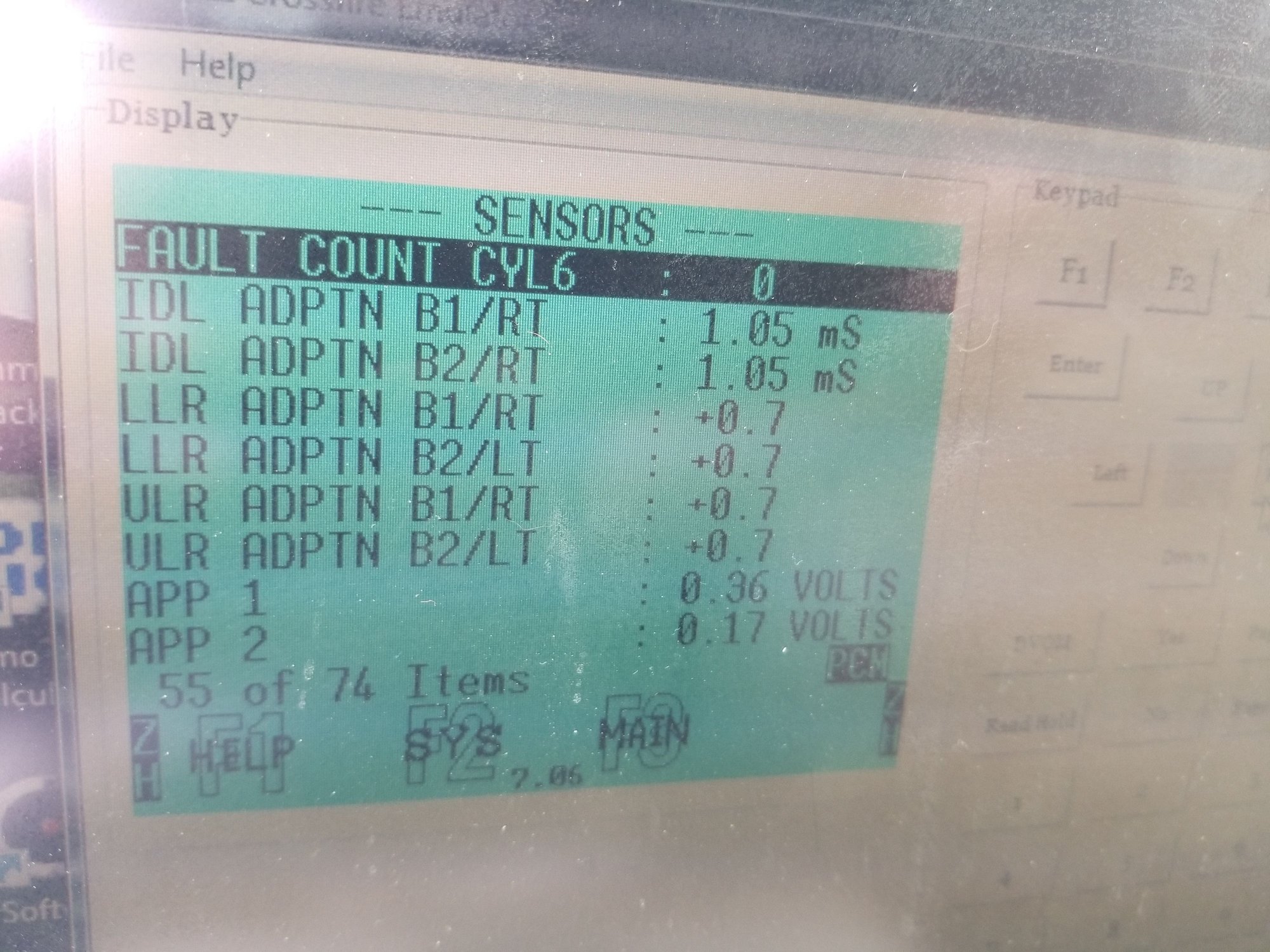

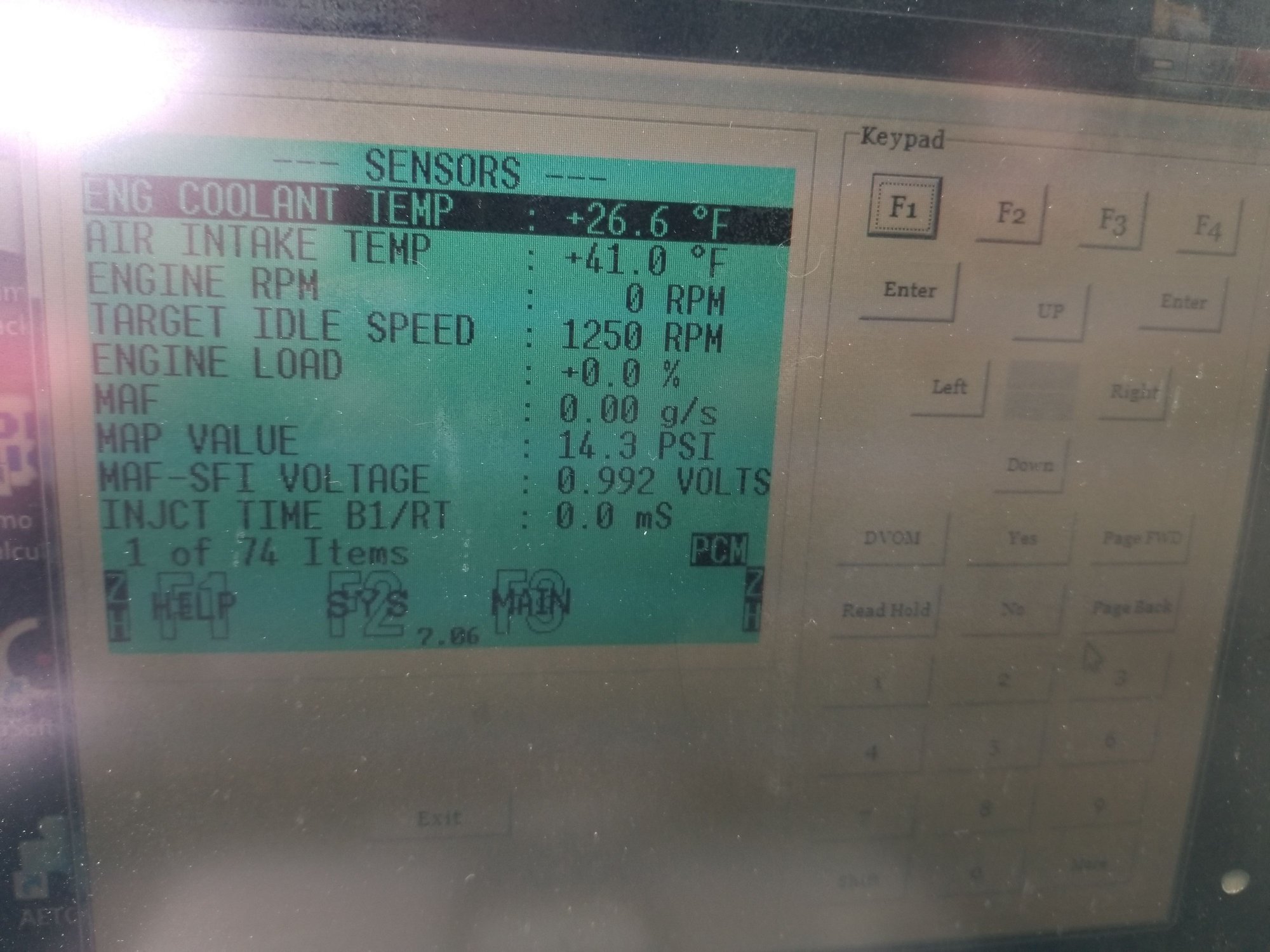

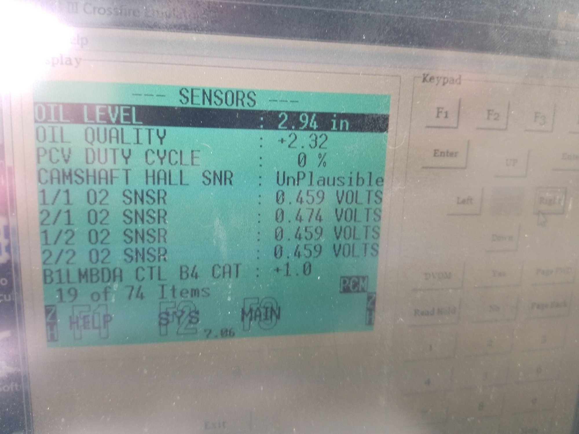

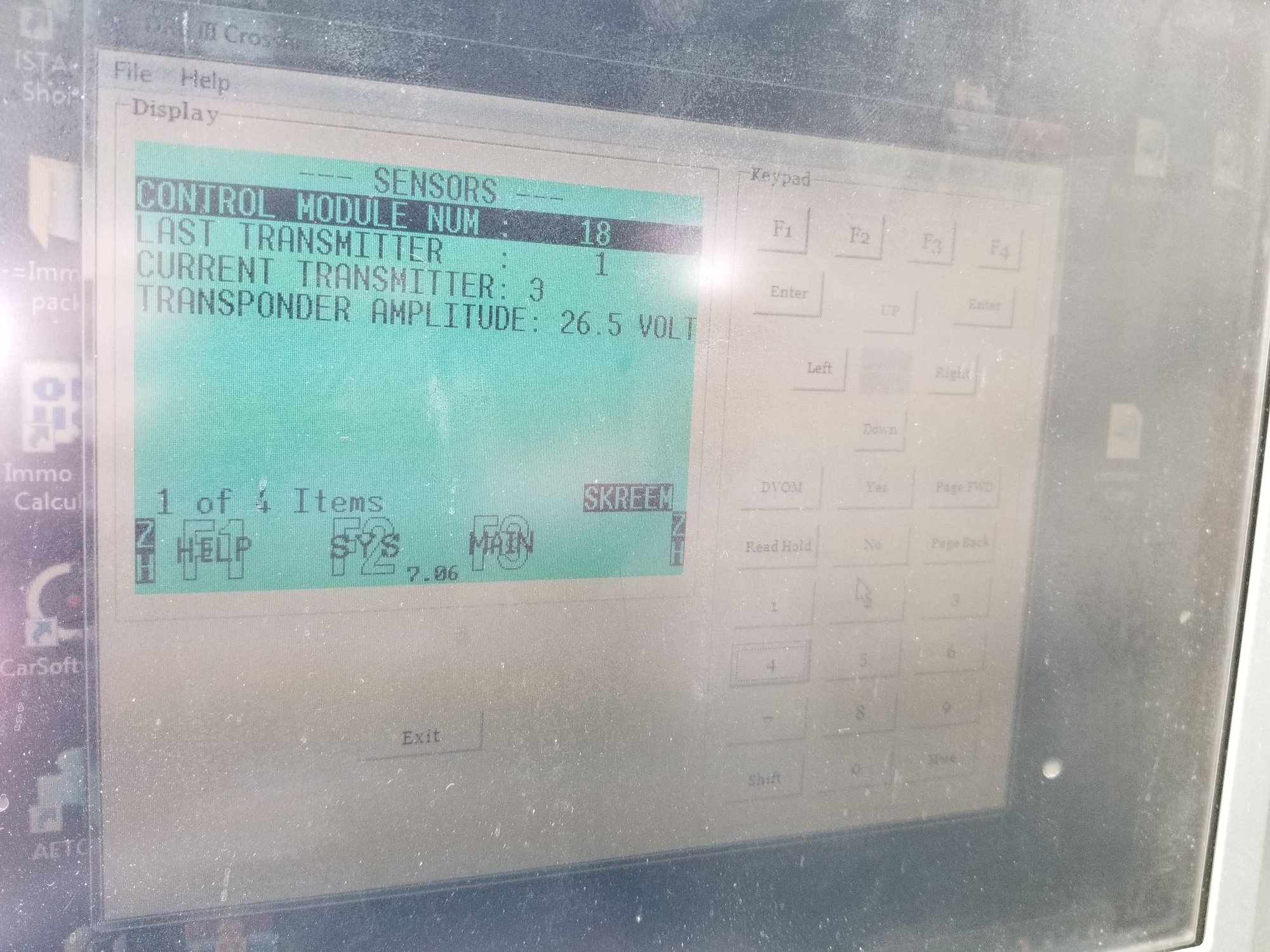

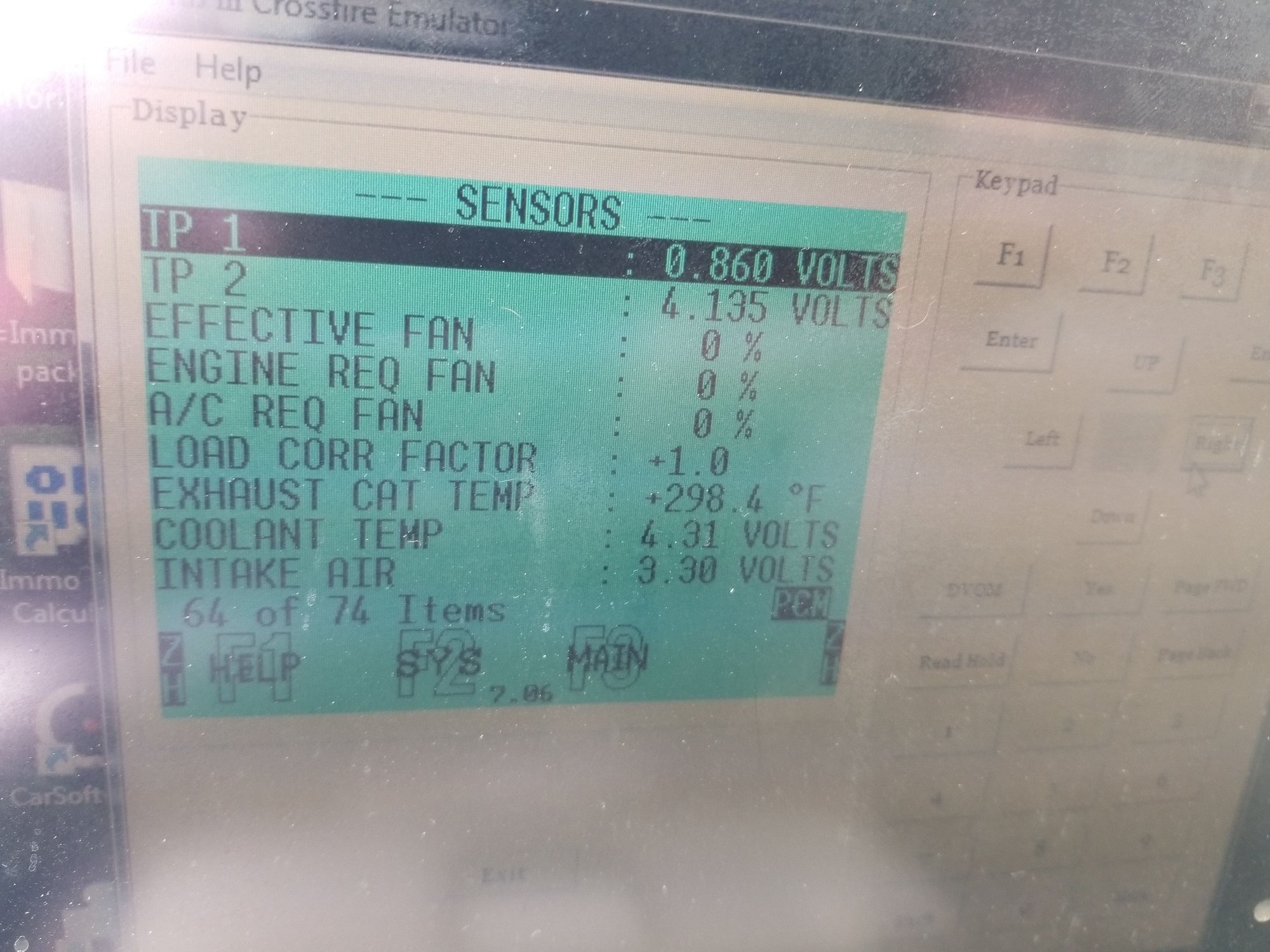

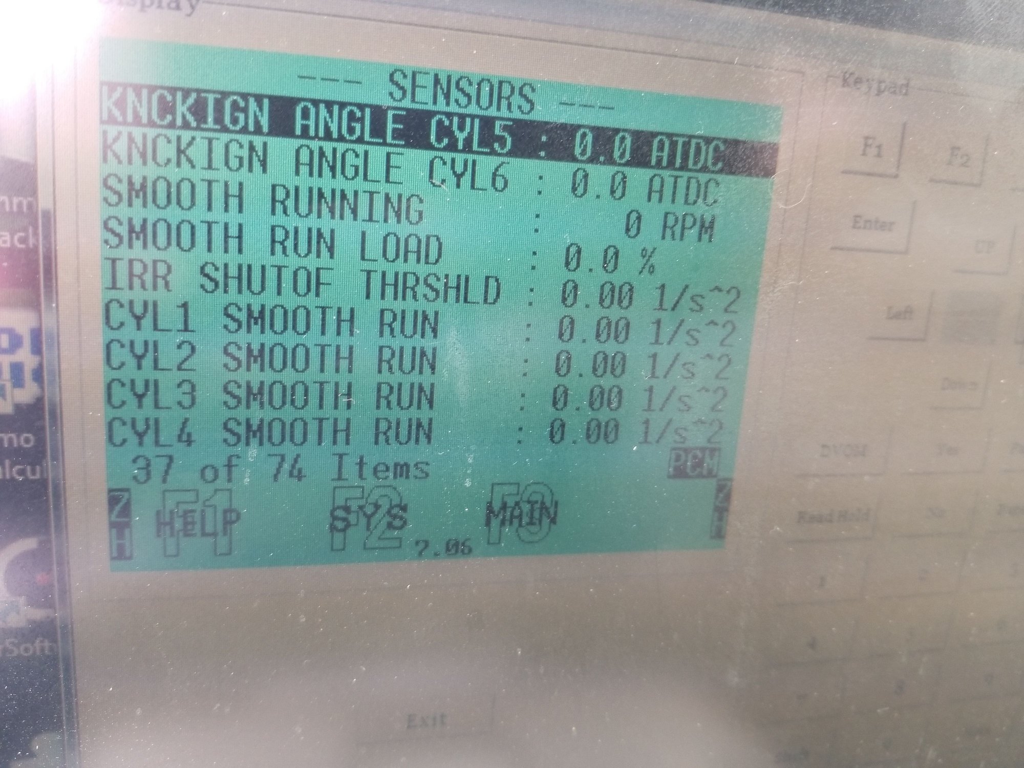

Here are some pictures of the sensor data from the pcm and skreem module.
Again, the things that stand out to me are the ignition angle which was -3 degs or so when it was running and the temp sensors for the airflow sensor being too high(was about 30degs outside at the time). Also it shows the cat temp at 300deg and since its been sitting that cant be right if thats what its saying. Let me know if you guys spot anything else that might help.
Using the drb3, I am unable to actually find anywhere where it says if the rolling key codes match from the skreem and pcm. It shows the transmittor for the remote lock/unlock but thats all I see.
Also in the pcm sensor data there is a value called S/C state. Does anyone know what that is referring to?

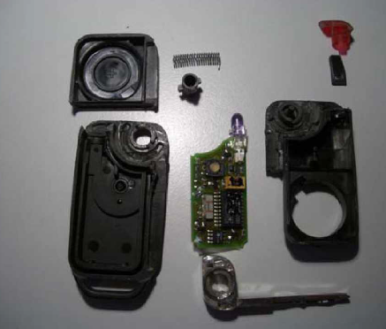

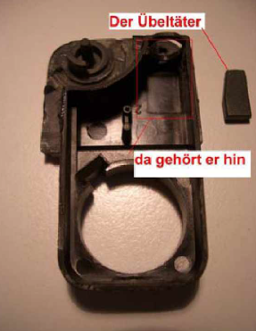

Ok. SOLVED. The issue turned out to be the key fob. I had ordered a new shell on ebay and I moved over the chip inside but turns out(i suppose alot of you knew this already but just in case) that the raised Chrysler emblem on the back of the fob is actually the part that the antenna ring is activating. I didnt take that off and put it on the new one. I assumed that was just cosmetic. So switched back to the old fob and it starts again. Thanks again to CL770 for his help.
So it appears the 54deg ignition angle is what will show with a drb3 if you don't have an authorized key in or your antenna ring is bad but will not show codes. Maybe that helps somebody if they find this thread.

That emblem has NOTHING to do with the RFID. I even have a different emblem on mine.
What DOES is the little chip in the fob like this picture :
Or this one :

Hey thanks for the correction ala_xfire. I had not noticed that piece in there at all. Sorry for the misinformation but hopefully somebody might find something useful in there somewhere.
