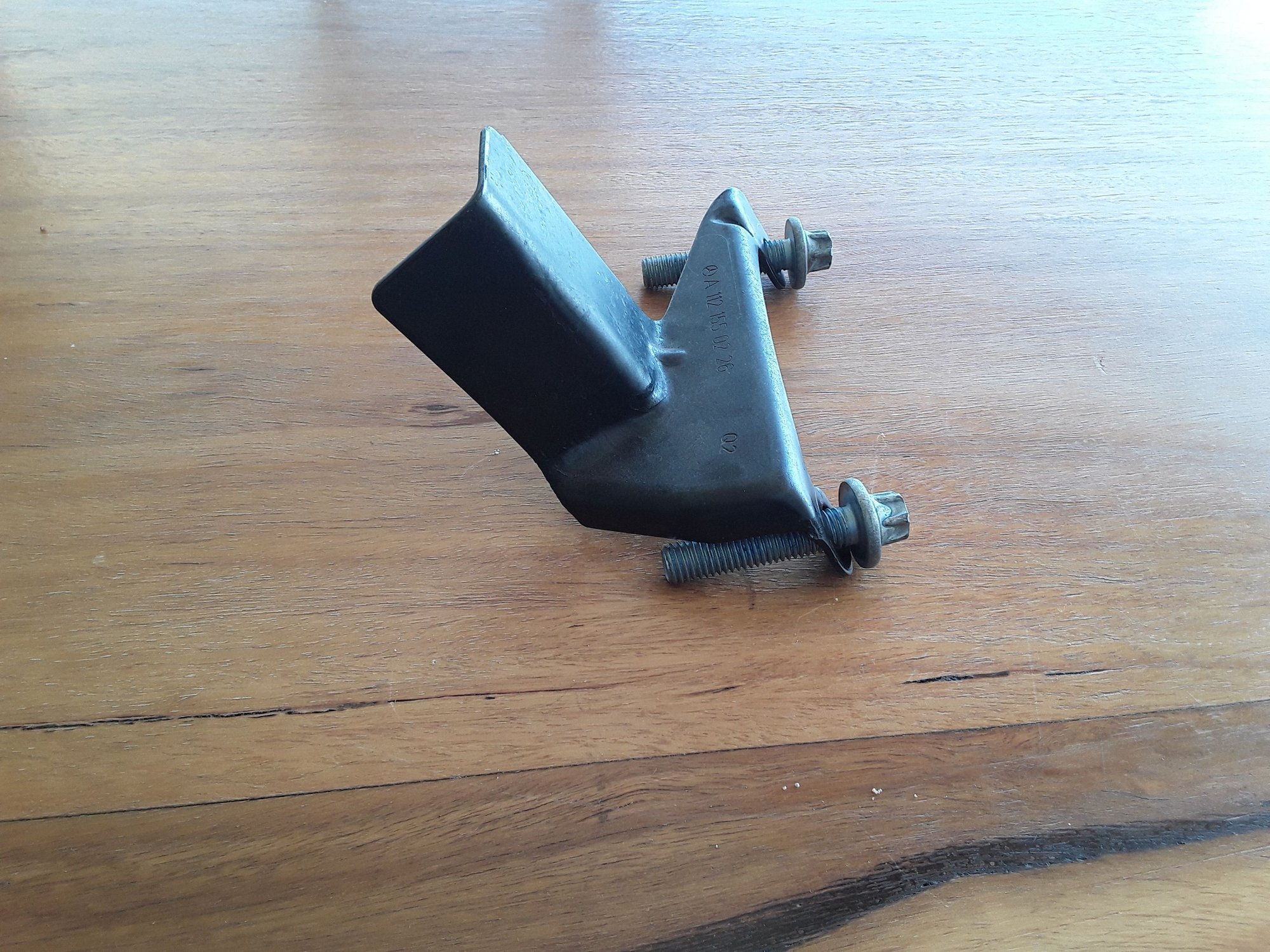

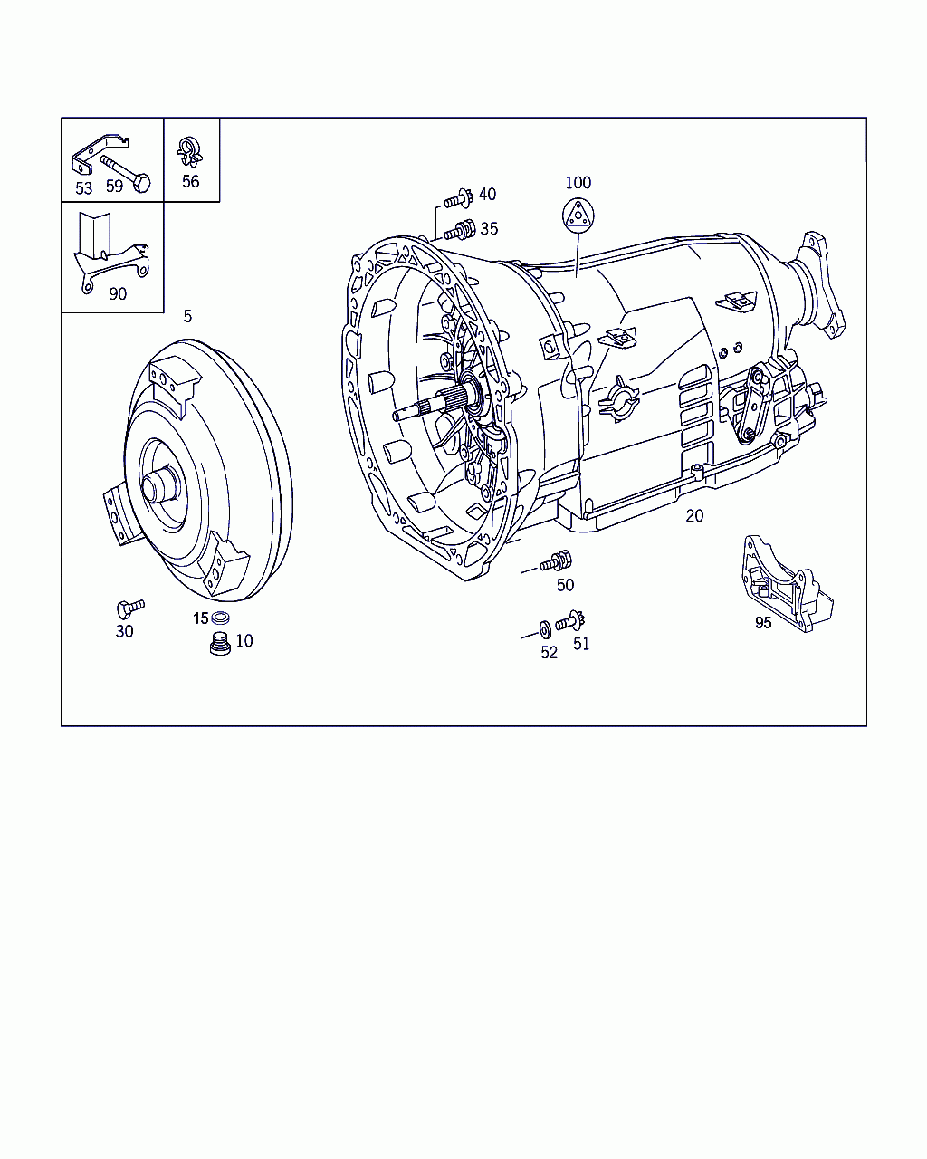

Problem now is that I have a part left over. It is described as a "protective cover" (part 90 on the diagram)
and over the last two months since the problem started, we forgot what it protects.
Part No. A 112 155 02 26.
Can anyone help?
Thanks
Ron

It's the protective cover/heat shield for the crank position sensor. It's held on by two of the bellhousing bolts. I wouldn't worry about putting it back on as I think you're better off putting some proper heat shield material around the top of the crank position sensor.
Old Nov 6, 2020 | 08:13 PM
Default Re: Car not starting - fuel pump relay
But I would recommend putting those 2 bell housing bolts back in.

Thanks CL770, found it.
Ron
