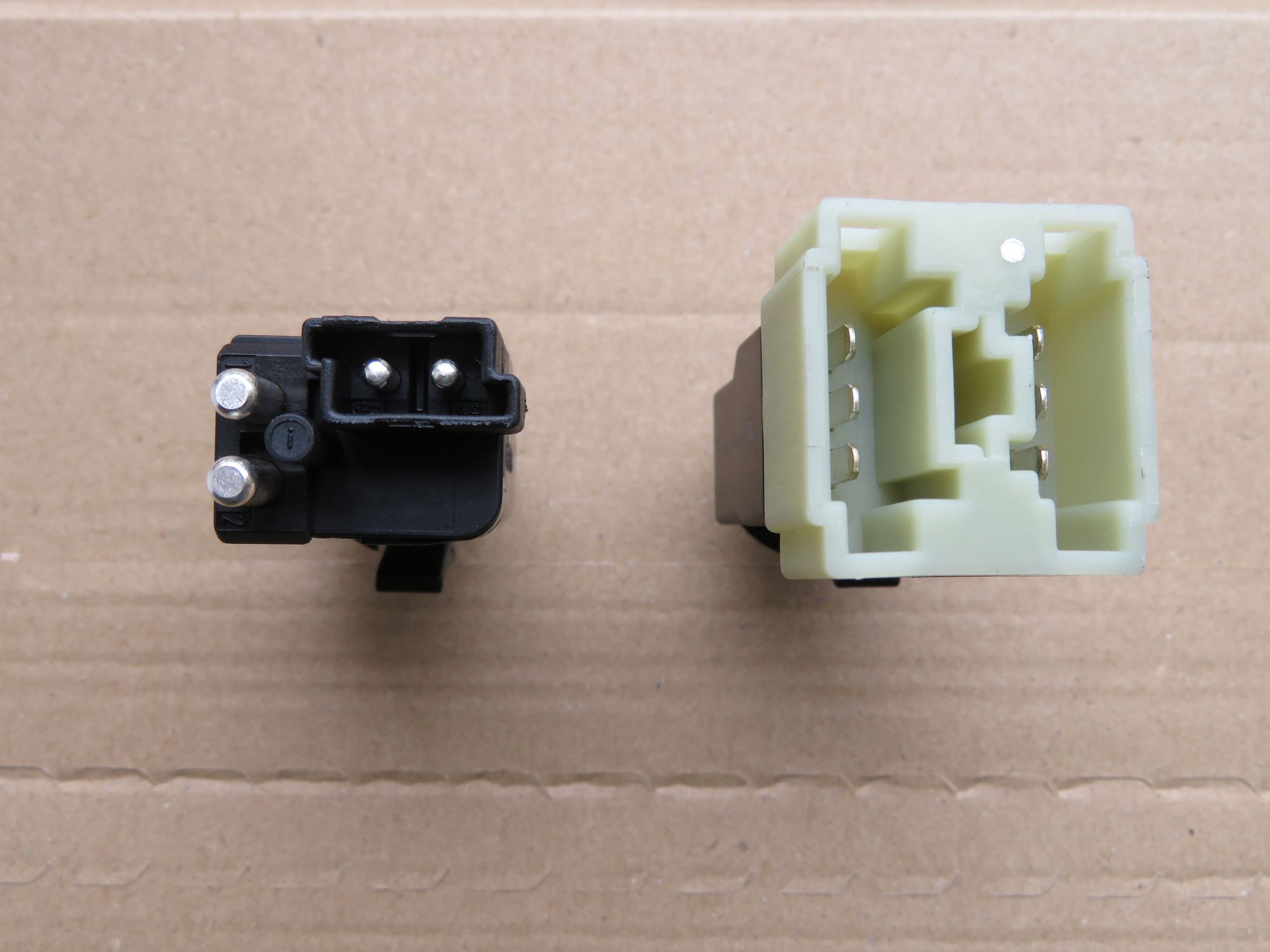

Amazon USA failed to deliver, further ferreting about revealed the correct switch for my 2003 manual coupe with same SLS384 part number from a UK supplier..........all good except it is the wrong switch. Today I removed the original one which has only 4 contacts, not 6, and a shorter push rod. See photos attached. The switch is a very common type and fitted to many different vehicles, the part number is 0015450109. Just be careful to get one with the correct length of push rod.
Correct switch on the right 0015450109
This is interesting. It appears that the manual has a different brake switch than an automatic. On the automatic cars the white end piece comes as part of the switch MB # 0015456409, but on the manual as in your picture their is no white piece on the end of the switch and the MB part number is 0015450109. That or they used a different set up on the European models? Also, the wires are different between the SRT6 and the N/A.
On the manual you have to keep your foot on the clutch and brake, on the auto you do not have to keep your foot on the brake when starting.
