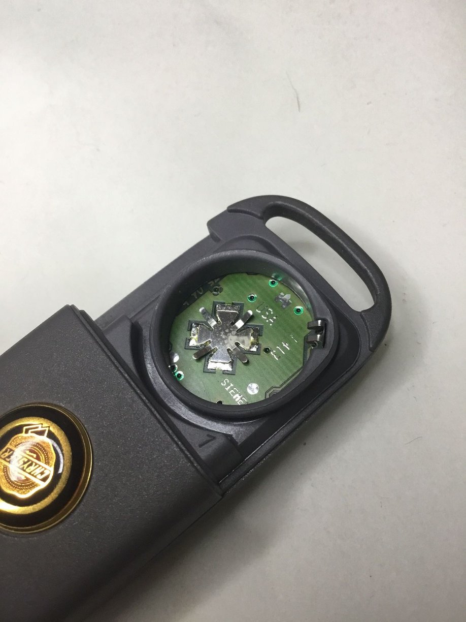

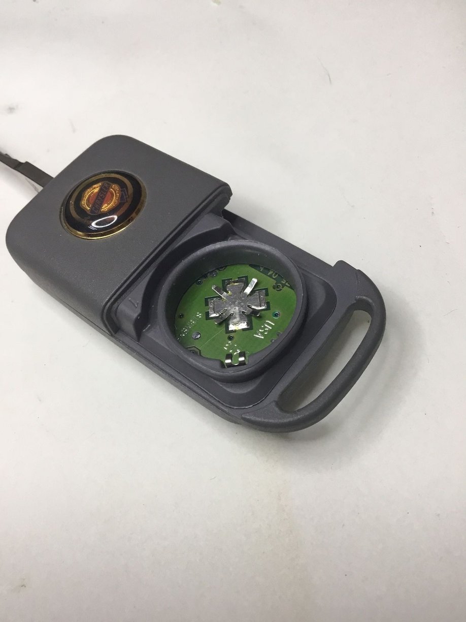

At this point I'm almost wondering if it is the contact tabs. The ones that stick out, attach in the little nipple by of the plastic key fob case. Is there a certain way they are supposed to be bent?
They look like little hooks...wonder if they somehow don't make contact.
I believe your contacts should have a circular (round) loop appearance and not look egg shaped, so to speak, as they are only supposed to make contact with the one battery

Either way, the fob is still not working. Kind of crazy...checked all the contacts and soldering points on the board and they seem fine...nothing looks worn, scratched etc. I figured since praying the key fob shells apart took a bit of force, that the looping contacts that are supposed to make contact with the batteries is at fault but now I don't know.
It says above it's only supposed to touch one battery. Which one is that? The top one? So basically the little "hooks" for lack of better term are supposed to hook on one of the batteries? Maybe mine are too bent?
Any tips are super welcome. And maybe I'm looking in the wrong direction...maybe it is a completely different part of the board that's the culprit. Not sure if anyone here had issues with their fob before and were able to fix the board...what was the culprit?

They just press against the side of the top battery. You didn't lose the tine micro chip in the very front of the FOB, did you? It is black and about the size of a small fingernail.

OP, a question? When you place the batteries into the FOB case (2032's 2 each I believe), does the 'bottom' battery have a chance to, or is it possibly 'touching' the positive terminal at all? IF that is touching, the one battery on top will drain & the FOB just might be 'undervolted'. Since the FOB was opened/closed at least once (maybe even more), that 'positive' terminal coming up and around the batteries may have bent inwards some? You might have already checked that but if by pressing the battery cover on, could it maybe push over and short that top battery (I do not think there is enough 'current' in those 2032's to actually heat up that much so you might not have noticed a warm case). IF there is a possibility of the upper terminal that comes around that bottom battery is touching, then you will have to find a way to prevent that from happening (and check if either battery is dead). I know you said the batteries are new but..... Good luck!
