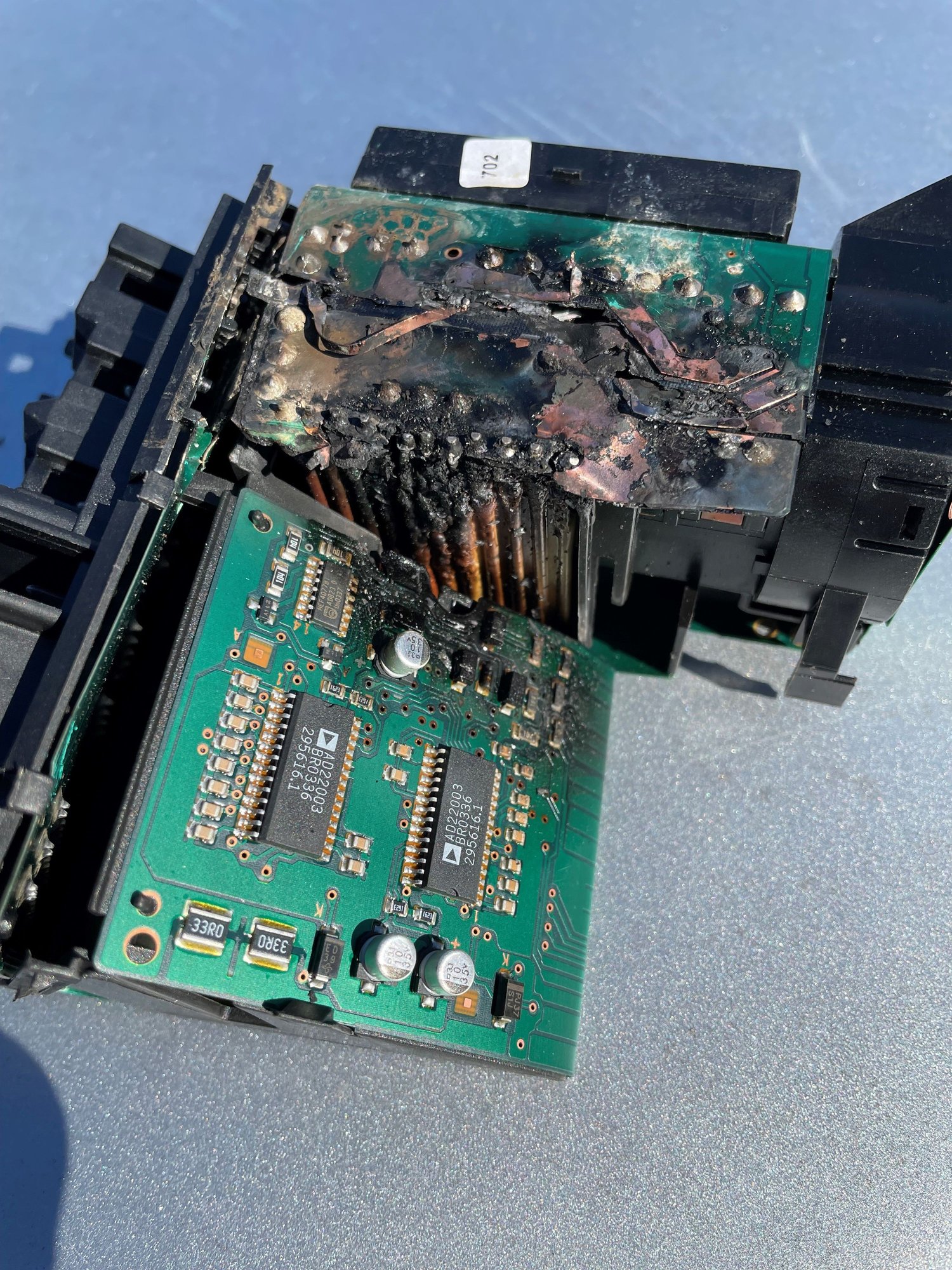

Here's a picture of the failed headlight control module.
I see signs of water damage and have circled the sites of said evidence. Since you don't know history of the car, who knows what happened in the past.
No fuse blew because there is no fuse protecting the ICM, the fuses on it protect the outputs, but the inputs to ICM are:
1) A direct feed from connection from splice block 100 in the underhood fuse box, driver's side. This is fed from a heavy lead going to the 200 amp fuse in the battery fuse box, next to the battery.
2) Two separate switched leads from the ignition switch. These are also fed from splice block 100.
You can flow 199 amps all day long and now fuse will blow. At 12.5 volts, a .1 ohm short will flow only 125 amps. Thats 1500 watts - a lot of heat.
