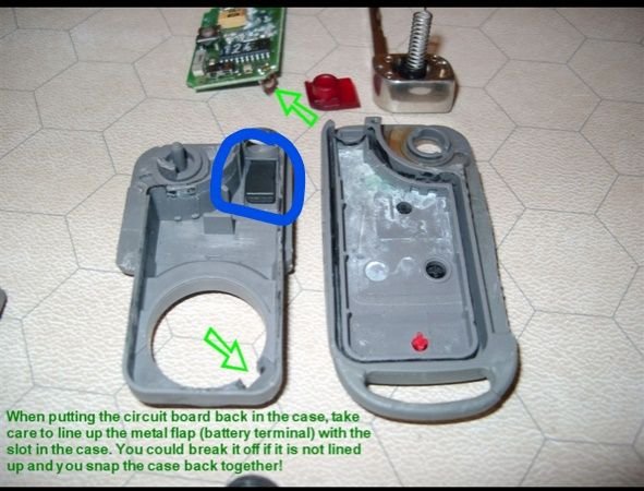

Try not to fall out of your chairs laughing at me, but, I figured out why key fob wouldn't work...
When I switched the guts out I missed the little transponder (?) imbedded in the old FOB. Moved it over and it worked perfectly first try! I feel so dumb...
The picture below is not my FOB, just one I found on the internet, but, what I circled in blue is the part I'm referencing.

Default Re: 2004 Xfire- smoke from steering column
Good thing you didn't toss it. A lot of folks don't research before attempting..
