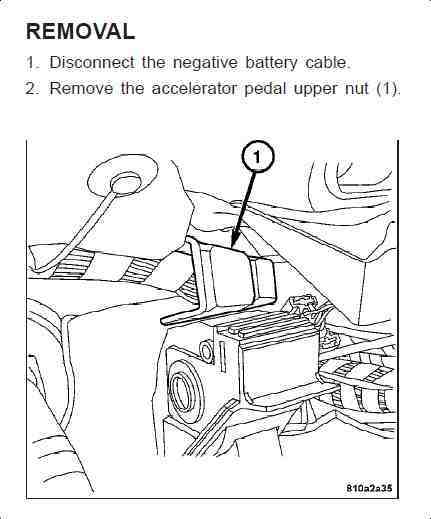

Where is the top nut please, I just do not understand the diagram.
Getting reoccuring P0122 and pedal to floor takes forever to rev.

1. Remove the lower nut cap.
2. Remove the 10mm nut.
3. Remove the washer, a magnet helps.
4. Remove the pedal, lift the bottom pulling out and pull it out of the upper bracket.
5. Unplug the tps cable from the sensor.

Understand the bottom, it is the top nut I can't find (diagram is from the '04 service manual).

That's because there isn't one. It should just pull out of the top bracket. Please reread post #10, unless 2004 was totally different.

OK will try, just was going by the '04 service manual & like to know exactly what I am doing defore I dood it.

At the top, on the back, is about a 1/2 extrusion that goes into a grommet that it just pulls out of once you are clear of the stud at the bottom.
