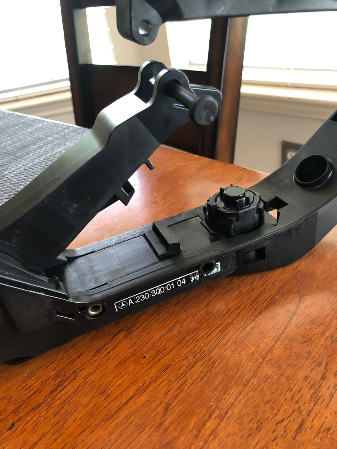

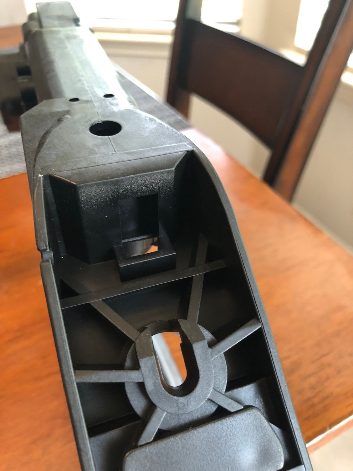

Followed this thread to fix Accelerator Position sensor, bought the replacement shown below. When removing original pedal, I noticed a second wire that goes in back and connects just below full throttle switch. The new one I purchased does not have a connector there. Is this something that comes out of the old pedal and fits into the new one?
The new APS
No connector on this one

Originally Posted by Texas Thunderman
I see now that I have bought the wrong part.
Texas Thunderman
The pedal part# you purchased begins with A230, the part you are looking for is A170. The 170 is the number assigned to the SLK model prior to 2005 and used in the Crossfires. MB apparently used the A230 in another model and changed the configuration and will not work in the Crossfire.
Time to return the part and buy the correct one A170 300 01 04....
Regards,
Dennis
