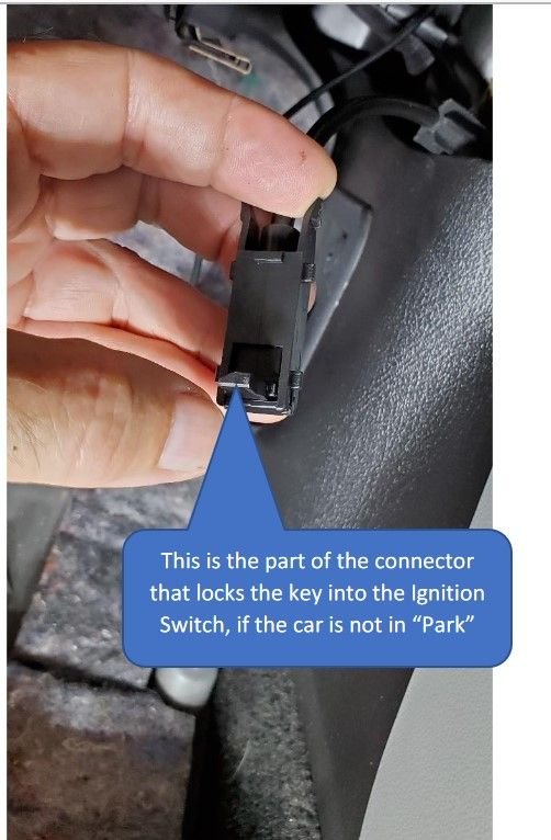

Originally Posted by nicolas-e63
Last thing I could notice. I don't have on my car the little black switch on the ignition :
Thanks to all
Nicolas
That is the "Key In" buzzer wiring, it will not stop the car from starting but I find it odd you have no such wires.
Is this eventualy only for automatic so that you can't get the key out if you don't have the shifting lever on P?
On european Crossfires there is also no key in buzzer.
No there is a cable that attaches to the ignition cylinder, (not electrical but mechanical) that comes up from the SLA in the autos for that function.
Here you go, from the "Sticky Key" document that Bob McCubbin wrote:

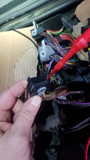

* Seems the ECU don't have the information when I'm pressing clutch pedal. Keep inactive, whatever I press the pedal :
* Control Clutch pedal sensor + wiring to ECU :
Pin 4 of the ECU to the mass. Open when we press the pedal = OK
