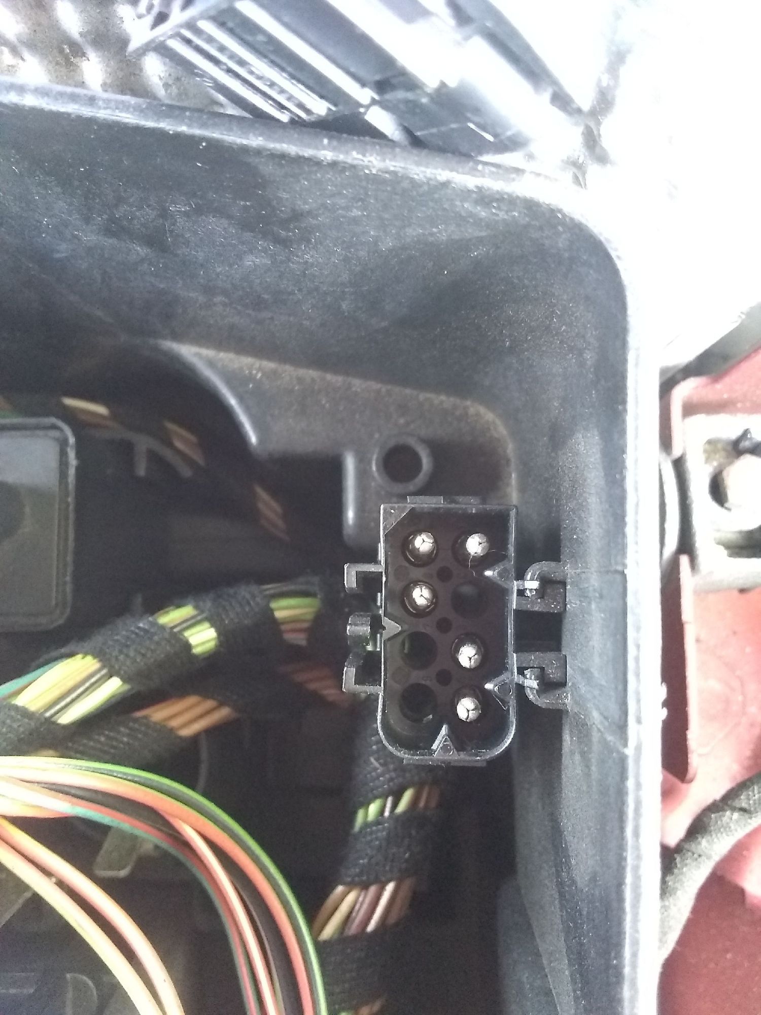

Here is a picture of the connector. It has a tag on the purple wire. I have forgotten which wire runs directly to the A/C clutch, but you can figure that out or check wiring diagram.

Thanks for the response, yes, I disconnected/reconnected the negative cable first. I am an old school mechanic with over 60 years of engine building experience, just not into all the electronics on the newer cars. Checked ALL the fuses int he fuse box just to be sure, all are in excellent condition, no faults. Read somewhere to put power on pin three in connector box 106 (Front of module box) but not completely sure which is pin three. Attached photo shows contents of connector. Any other ideas would be appreciated.
Side note, when engine is running and the AC switch is depressed, the red light illuminates and the engine speed increases approximately 20-50 rpm even though there is no visible operation of the clutch.
