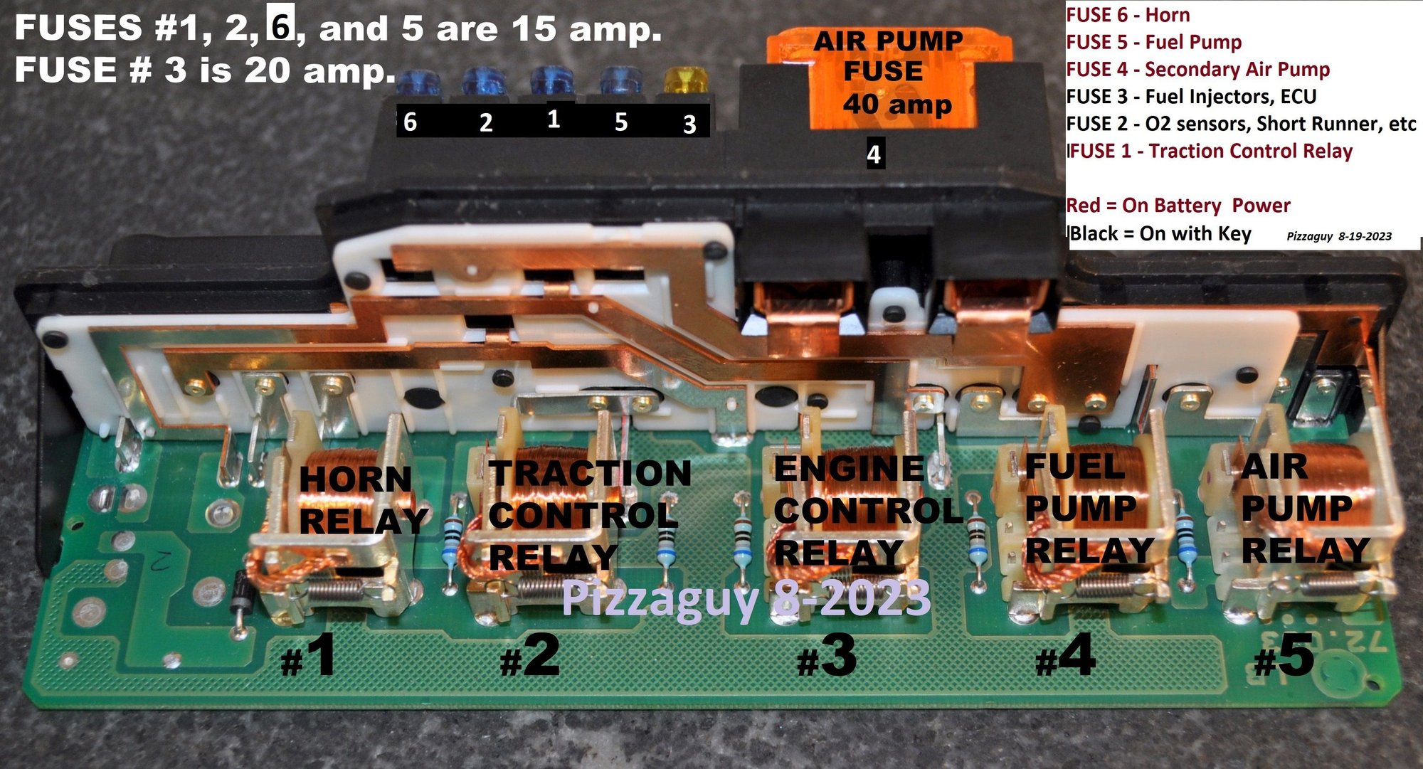

Originally Posted by MikeN
Took my 05 roadster for a drive and first the wing popped up at low speed and stayed up, then a bunch of warning lights came on, the speedometer quit and the brake lights wont work. Everything else works! Any ideas?
Dead give-away in red bold above. The brake controller has no power, so:
  1. The brake light switch is operated NOT by the pedal (that switch is for the starter interlock and SLA [shift lever park release]) but by the brake controller, which is dead, so the controller cant turn the brake lights on.
  2. The instrument panel/"message center" is telling you it cant talk to the brake controller, again, because the controller is dead, so the panel is turning on lights, to indicate there is a problem.
  3. With no wheel speed sensor data from the brake controller, the BCM is making guesses as to when to deploy the wing, out of concern for safety: Maybe you are going 120, better put the wing up.
What is wrong:
The "Traction Control" output from the RCM has failed. Check your RCM fuses (see below, fuse 1, note that it is the MIDDLE fuse). If the fuse is good, put your spare RCM in and send the bad one to D.J. for rebuilding. It's probably the relay itself, it's coil is open.
How I know:
Those who want proof: You CAN PROVE what I am saying, by yanking the Traction control fuse from YOUR RCM, you will get the exact same issues he is, put the fuse back in, and all works again. I yanked my TC fuse one day and went for a ride up the street, had just what he has now.

@MikeN :
"Spare RCM?"
As of last fall, here is my rule number 1:
1A) The car does not leave the garage without a new or rebuilt-by-DJ spare RCM in the trunk.
1B) The car does not leave the garage without a new BOSCH Crank sensor in the trunk.
I have been left stranded by my Crossfires three times: once for a "sticky key lockup" in 2010, once for a CPS in 2013, once for an RCM last fall - NEVER AGAIN!
What is wrong:
How I know:
This looks like plagiarism to me, I note the mistake that was corrected and the additional info but adding your name to my original is like me signing my name on the Mona Lisa.
My people will be talking to your people.

This looks like plagiarism to me.....
I thought Bob McCubbin made that originally. See, this is why I put my name on it, not only to try to be honest, but also, if a mistake is found, we all know who to blame.
Old Sep 1, 2023 | 12:19 PM
Likes: 651
Default Re: Gremlins in electrical
I posted this photo some time before 2016, there was another one before that even.
How I got the fuse numbers mixed up is beyond me.
Old Sep 1, 2023 | 01:17 PM
Likes: 1,298
You probably trusted the service manual....................
Old Sep 9, 2023 | 04:26 PM
Copy right infringement on page 3….. thankful for whoever did lol….saved a lot cars and grief!
Old Sep 9, 2023 | 08:22 PM
Likes: 651
The original marked up photo was posted by me in 2010 and updated in 2016. I guess I a going to update it again and get it correct this time with a little luck. 🙄
Dave, I have had a "onedrive" failure and have lost almost everything, I will be rebuilding my harddrive over the next months - so hold on to what ever you find of mine!
DO NOT TRUST OneDrive.
