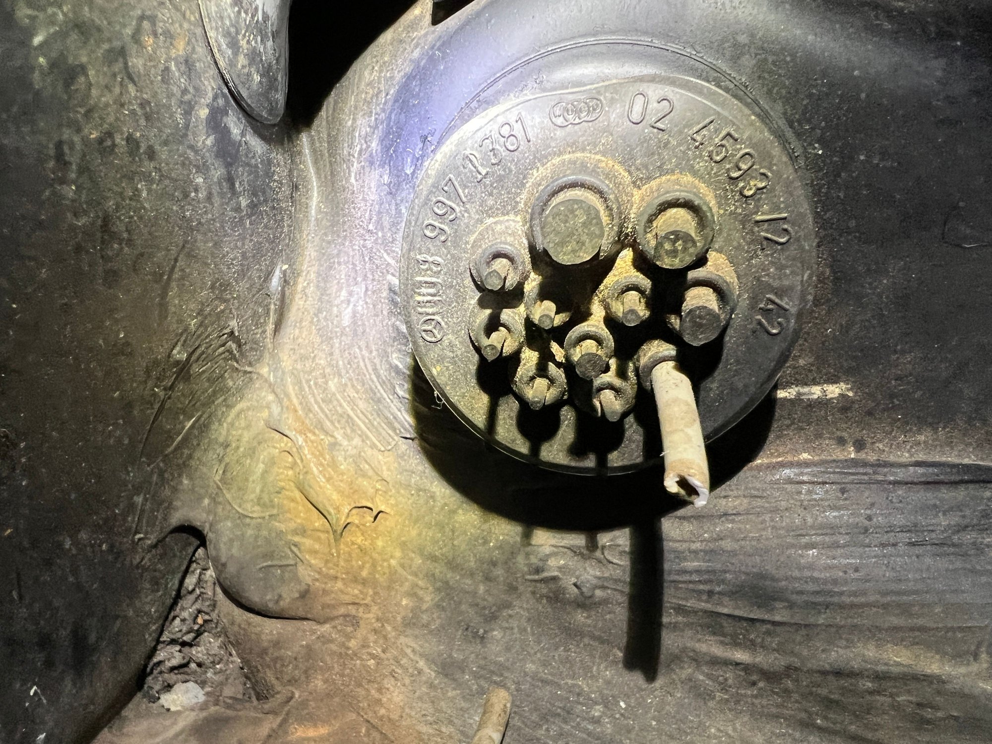

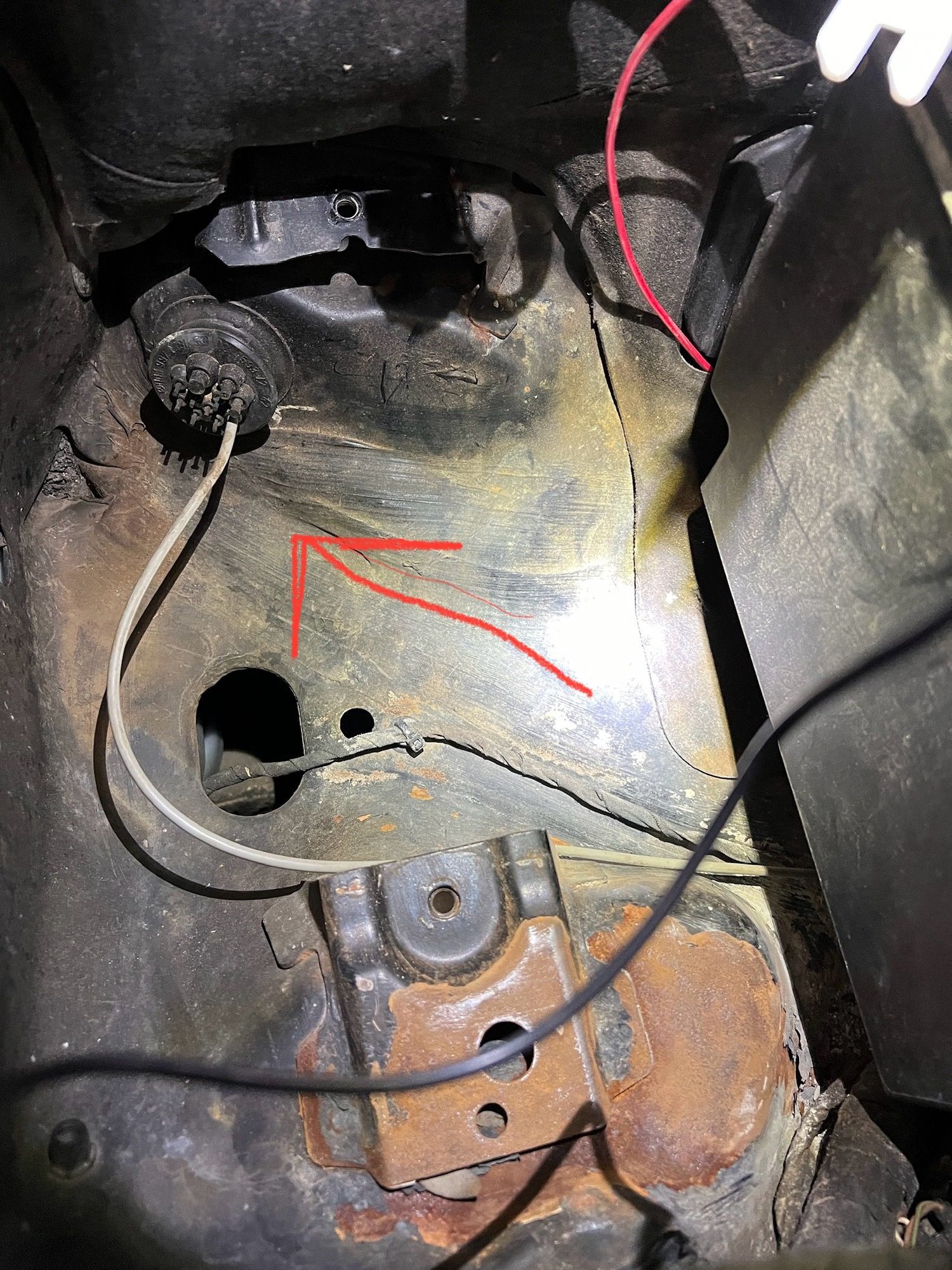

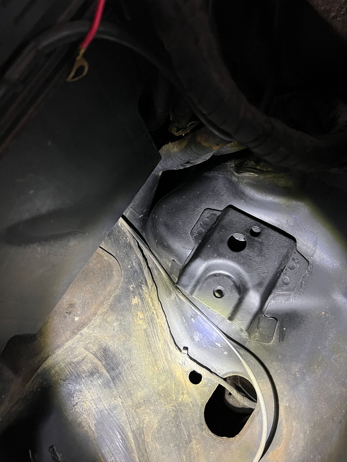

Hoping someone can assist - what is the thin tube that runs under the battery tray in my '05 base roadster? Prior owner had a battery leak, battery tray and adjacent fender lining rusting badly. Took it apart, sanded and primed, but in the process this tube (see photo) broke. I cannon figure out what it is - in order to replace it!

Pre-breakage (also notice the rust)
Broken tube as it appears to pass through the firewall
At least it's not rusted anymore...

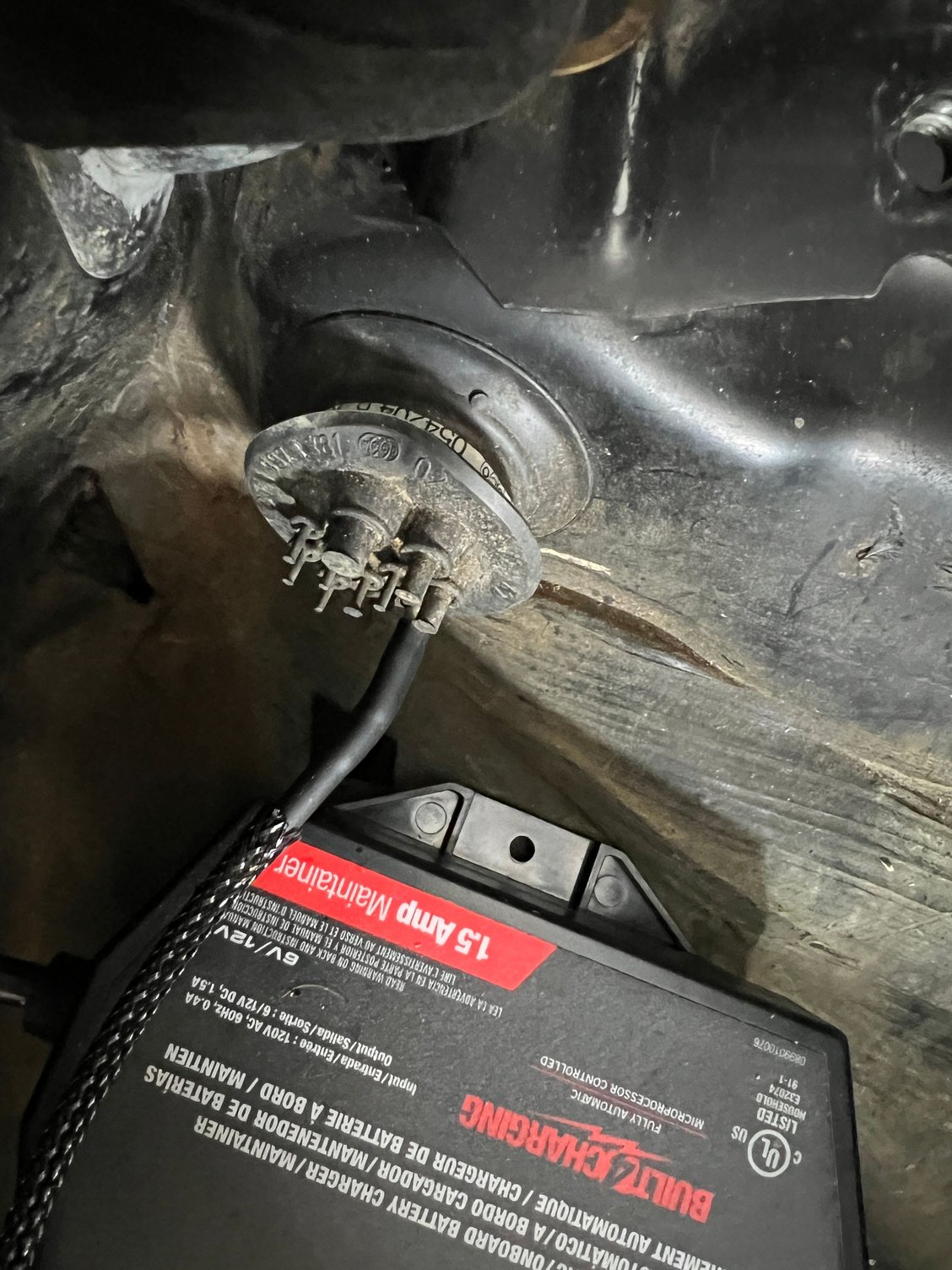

For anyone following: I used a heat-shrink connector to secure the broken ends (after holding in place temporarily with thin layer of electrical tape). Used a heat gun - luckily no vulnerable parts in the area, though I did insulate the rest of the vacuum line and nearby plastics. After the repair, covered the vulnerable portion of the tubing (under battery in the event of a future leak) with braided electrical wire cover for good measure, (in photo, you can see my trickle charger)
