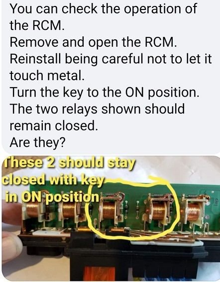

On the Facebook group they recommended to change the Relay Control Module.
Any suggestions?

Yep, bad relays in the RCM would be my guess. Changing it takes 10 minutes tops.
