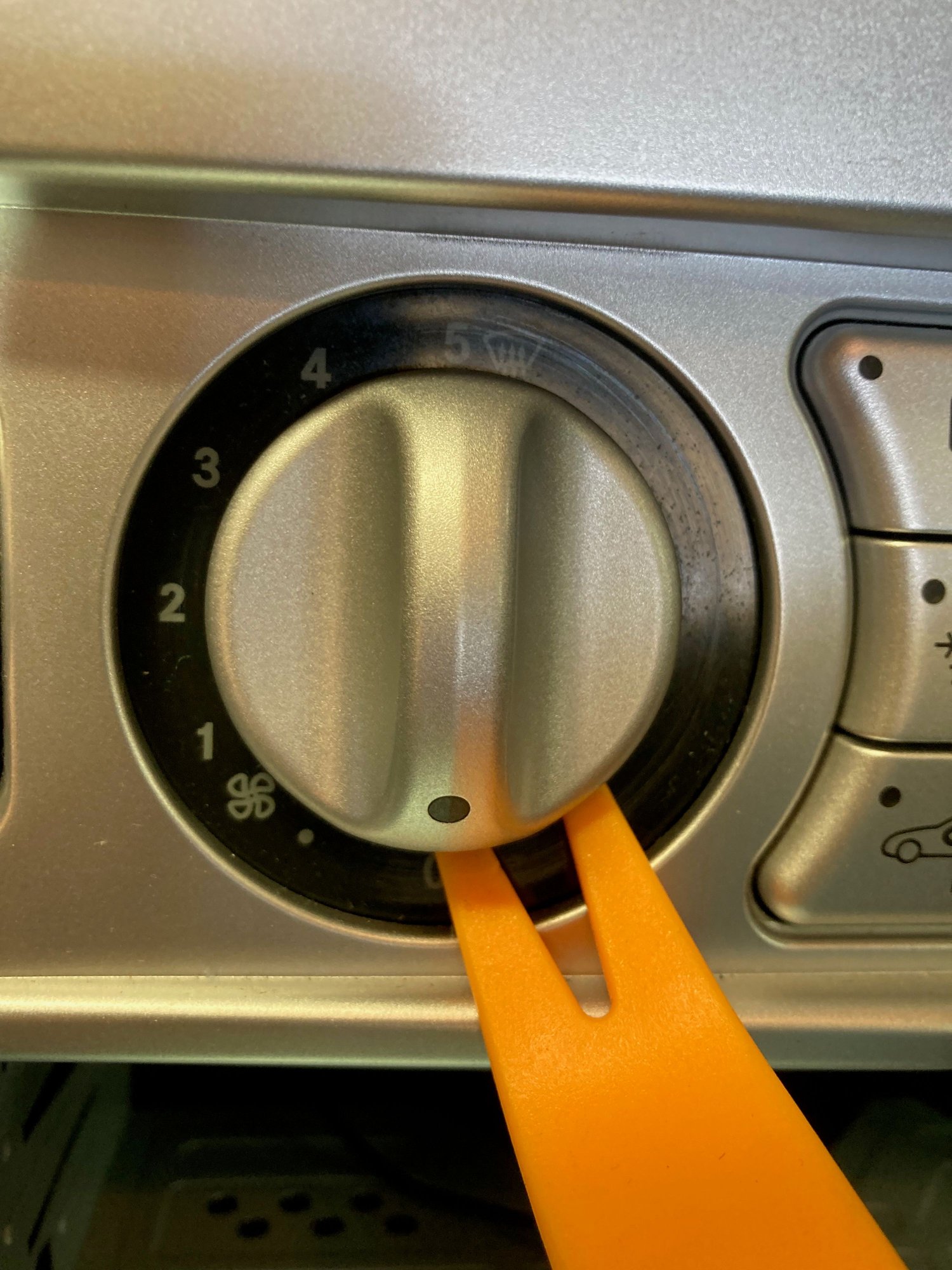

Step 1:
Carefully pry off the fan speed **** from the front of the unit, I used a small trim tool to slip underneath to the spindle in the middle and gently pried it off
Step 1

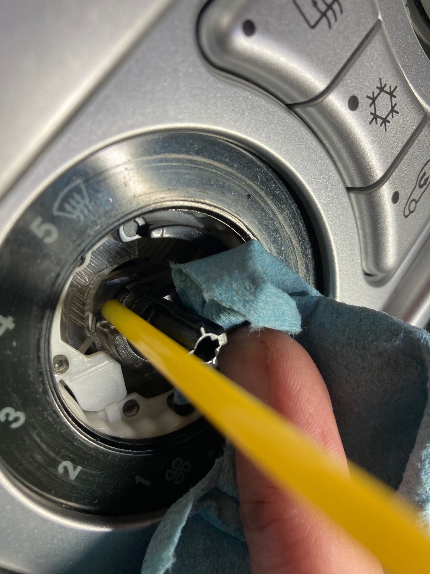

Step 2:
Deoxit can take finish off plastic, so you want to be very careful not to spray it everywhere, I held a shop towel directly underneath where I was spraying to catch the excess. First I sprayed some Deoxit into the hole in the middle of the shaft of the potentiometer
Step 2

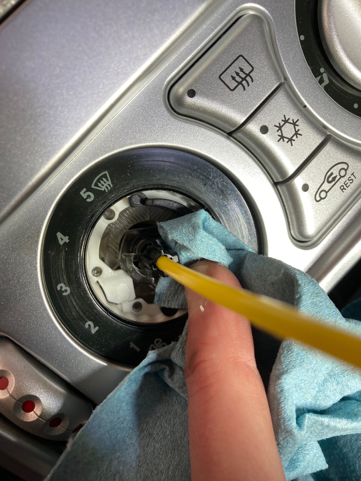

Step 3:
Next I used the straw to spray the deoxit into the small holes around the perimeter of the potentiometer
Step 3
I repeated this two or three times to make sure everything got thoroughly lubricated. After this I wiped up the excess, put the **** back on, and turned the fan control from off to full speed about 20 times. Now the fan control works perfectly on all speeds, no parts required.

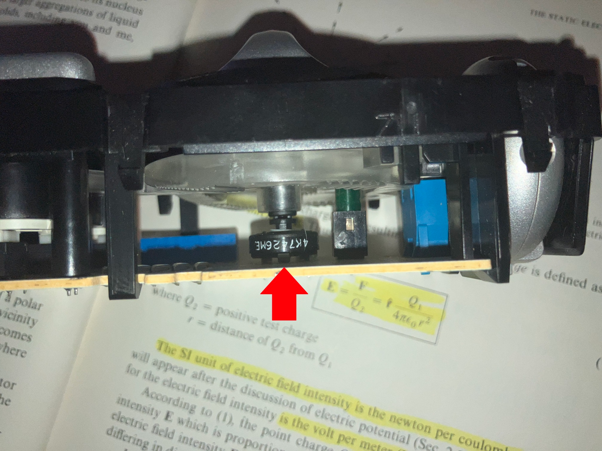

I am surprised you get enough in there to make any difference, you have only that seam between the white circle and black housing to get fluid in there, (with a similar seam on the back side if you get it to flow around the pot itself). [Yellow arrow]
The front panel, shown for perspective, pot is at the red arrow this time:
