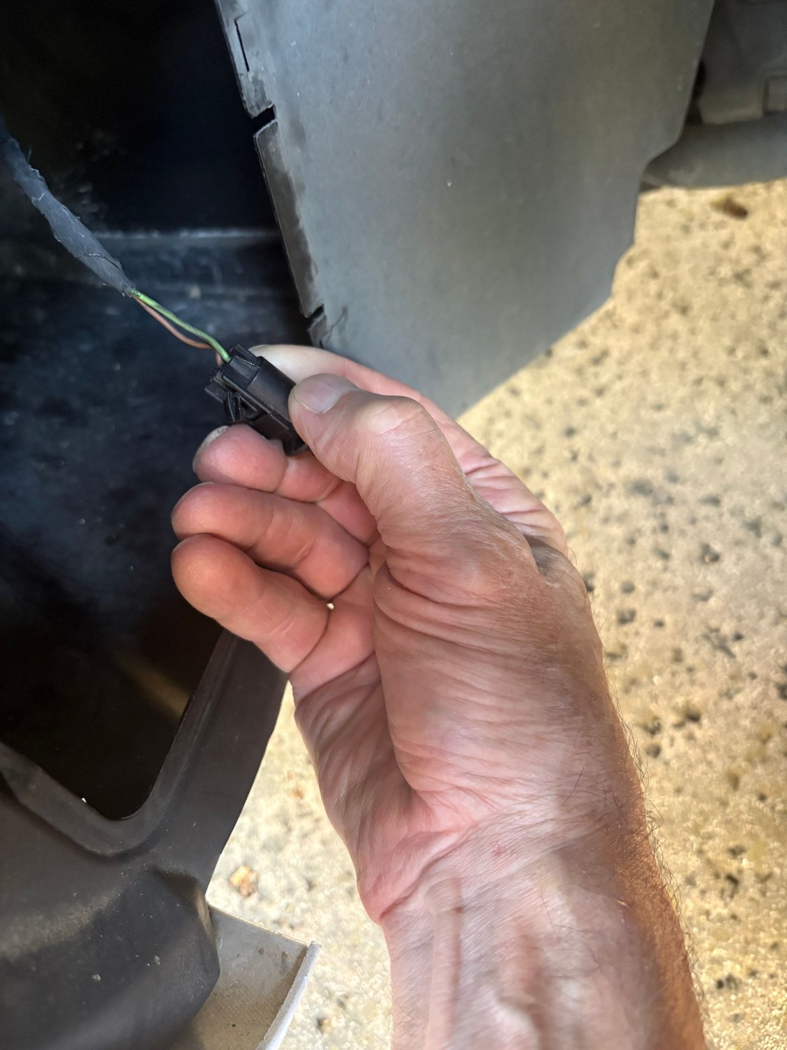

my outside air temp is reading -36, I replaced the sensor but it still reads the same, I disconnected the battery for awhile hoping it would reset, but it did not, AC works fine and its not giving any codes. any ideas? TIA

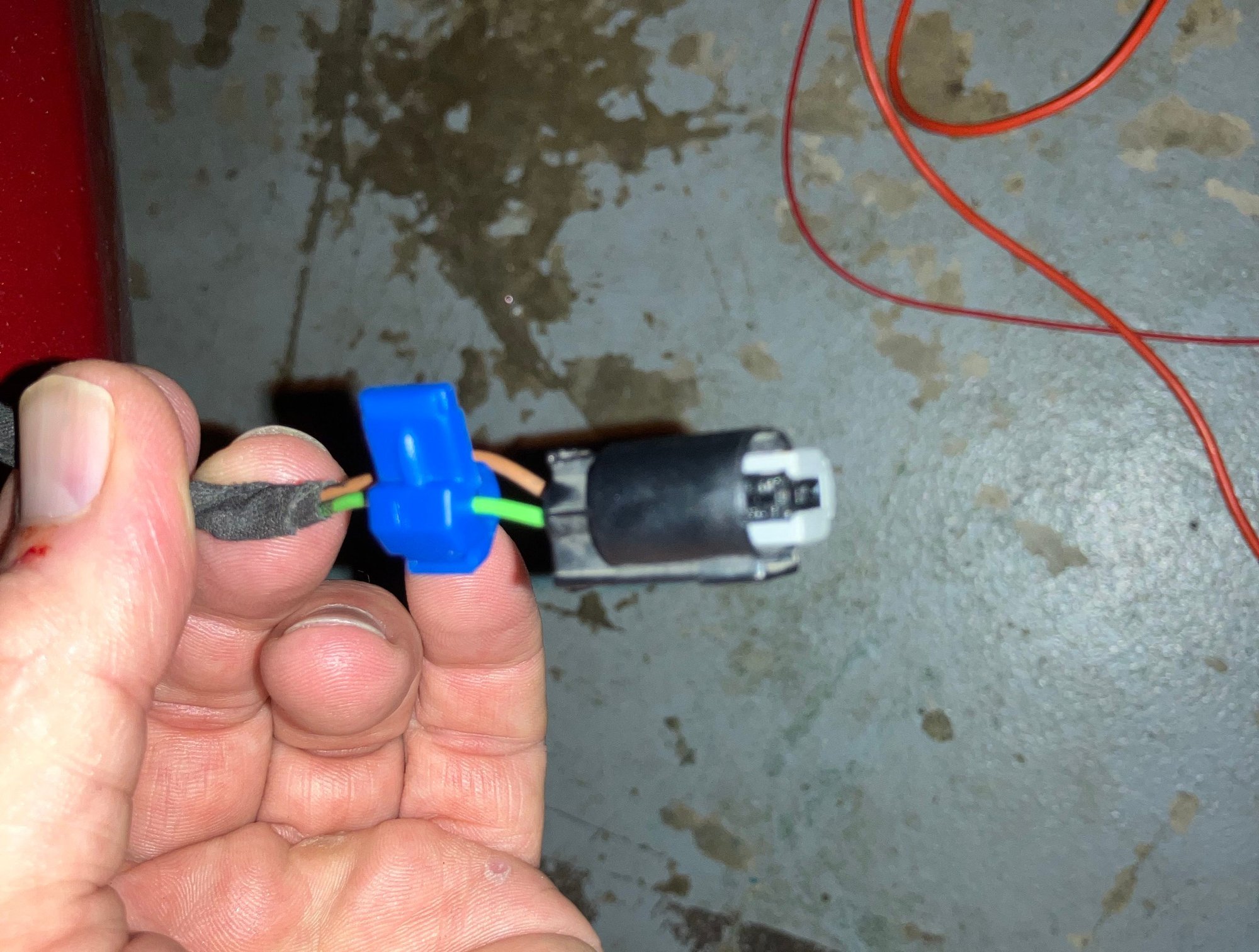

It's a simple circuit driven by the Instrument Cluster's microprocessor. Here is how it works:
The GREEN wire is a constant current source and with no sensor plugged in, it should have 3.00 volts in it, referenced to ground of course.
The BROWN wire always shows about .05 volts, it is close to ground.
Both wires go directly to the connector at the Instrument Cluster, if the display lights up, it is not a fuse.
At 3 volts, the display shows -36F (or C equivalent).
The sensor is a variable resistor and its resistance goes lower as the temperature goes higher, 91F (or it's C equivalent) will lower the resistance of sensor such that the voltage will drop to .96 volt.
To measure the voltage with the sensor plugged into it is impossible as there is no exposed contact on the back side that you can get to. I used a "tap" to measure the voltage both with sensor unplugged and sensor plugged in with the garage at 91F.
NOTE THAT IF THE BROWN wire is open, you will have 3 volts on the green wire and a temp of -36 at all times. So with the sensor plugged in, you should see around 1 volt on the green and ZERO on the brown.
I strongly suspect you have an open in the green wire, probably right inside the connector at the sensor, tho it could be father up towards the IC but the manual claims there are no other connectors in line between the two ends.

Thank you, that’s a lot to digest, for me anyway, any idea where I can get a new connector?

Can really tell by just looking, look’s intact, I’ll put a meter on it when it cools down

I really don't know that the problem IS the connector, but it might be. I am unsure if you can get the sensor or the connector for the Crossfire - but the SLK320's sensor and connector are the SAME ITEM.
You might search for "ambient" or "outside" temperature sensor and connector for the SLK320.
THere is, of course, always the local salvage yard - look for a car that was rear ended!

I already replaced the sensor, I'll try and replace the connector next
