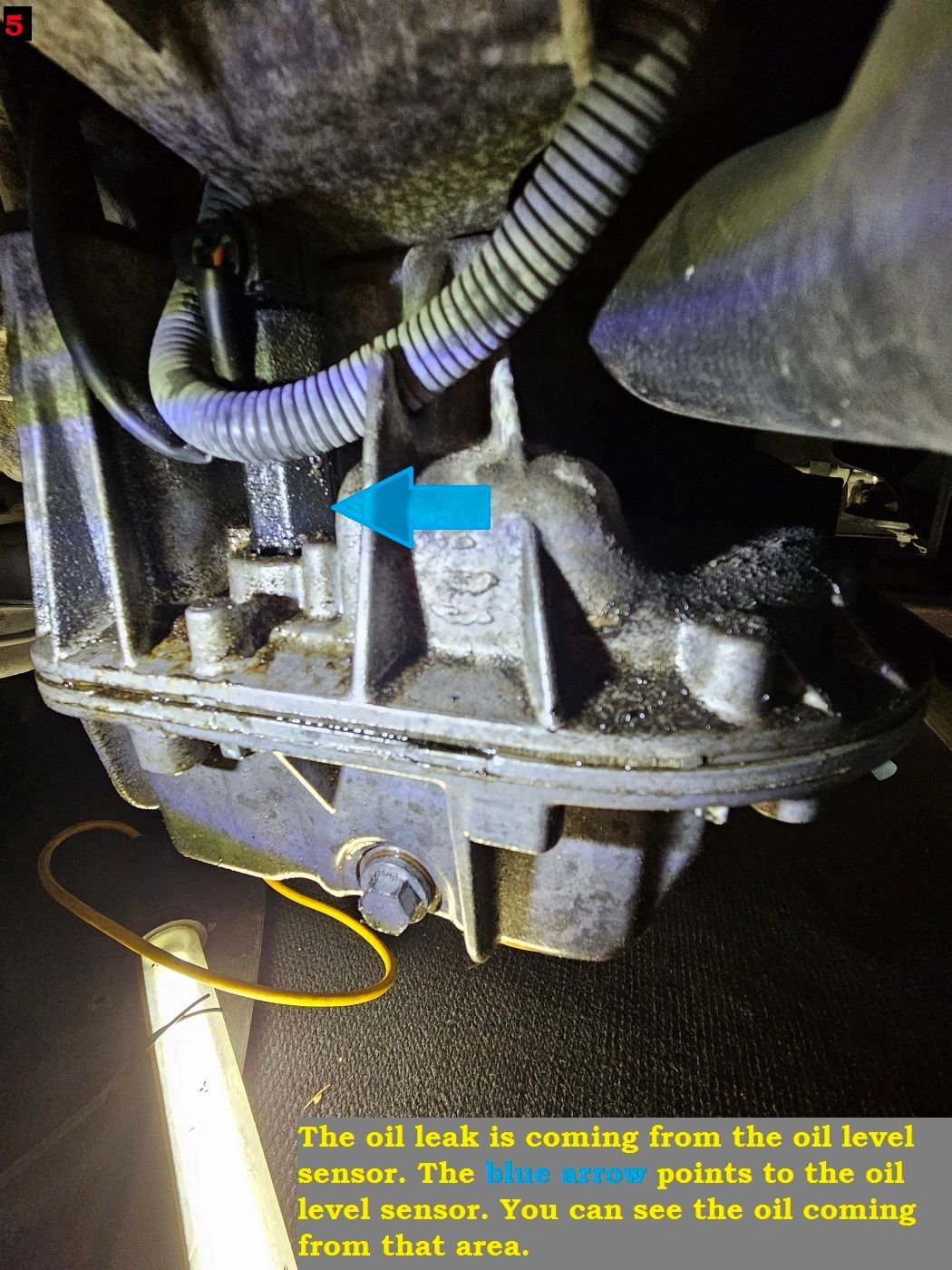

It might be your oil level sensor, if most of the oil is on the left side as you look at the front of the car. I just replaced mine a couple of weeks ago. Here's a link to the post that I did: Oil Level Sensor Replacement
The picture below shows mine before I replaced it. I held my phone up there and took the picture and saw all of the oil around it. Take a look at yours and see if you have the same trouble. It's not very hard to replace them.
Good luck!

Hi there, it turns out there were multiple leaks, and you're right... the last one - I hope - is indeed a leak from the oil level sensor. I will try this myself, but can I ask: in your case it was a faulty sensor - could my sensor be okay but just needs reseating, sealing, tightening or something similar? My sensor looks quite new. I guess if I'm going to the trouble of opening the oil pan, I might as well replace it. Could you please link me to the part you got.

@HumanMode Hi, I got mine from ebay for $89.00 Mercedes part number is: A275 905 00 00. You might be able to get it at your local dealer.
Here's the link to my detailed post when I changed mine: LINK - Oil Level Sensor Replacement
Removing the lower oil pan is the hardest part of the job because it is really stuck on there. They used a sealer instead of a rubber gasket. Just take your time and you can do it.

I would replace the whole sensor. People have replaced the o-ring and the sensor still leaked.
