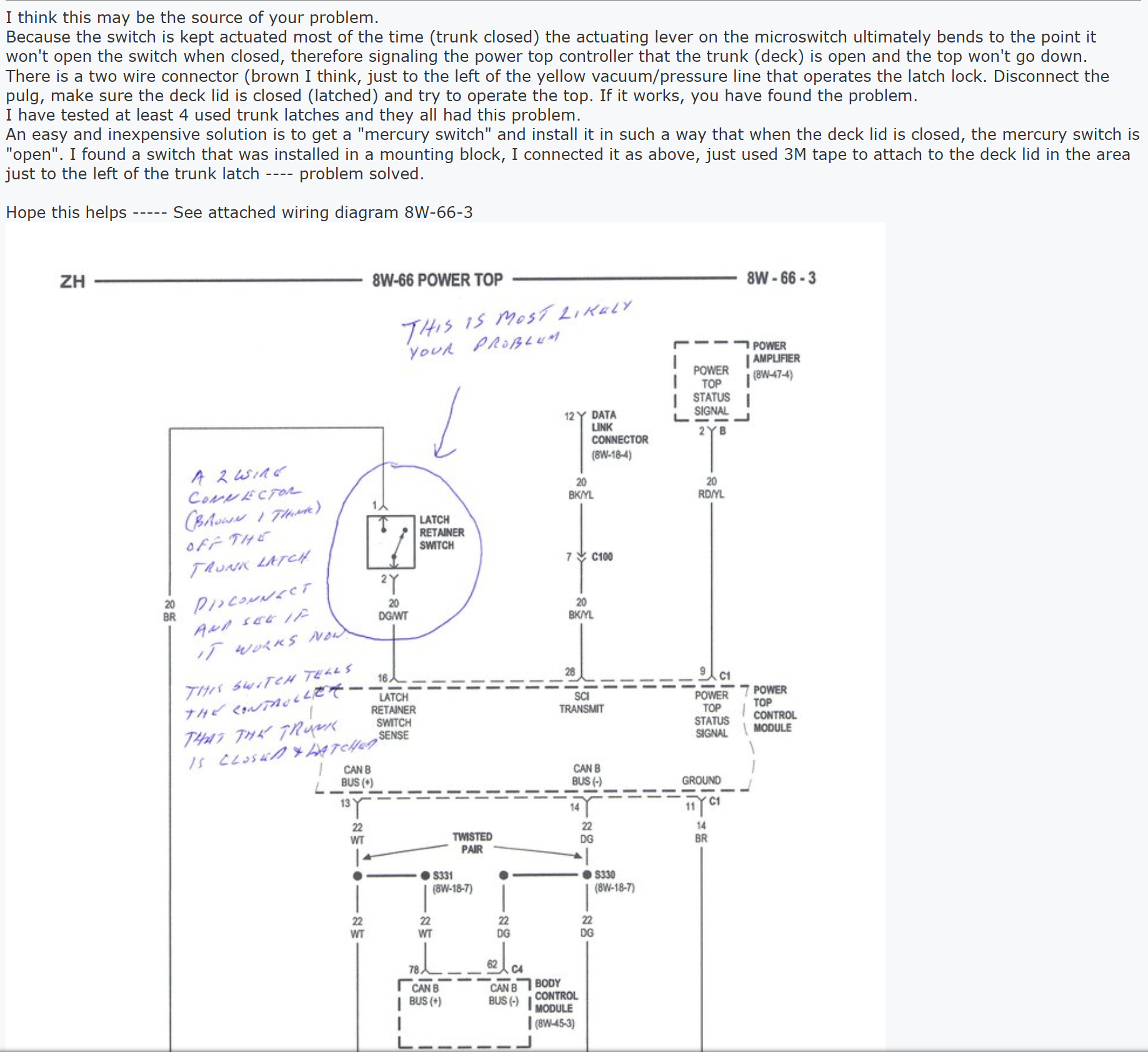

Found another posting about a lead. I have all the trunk cover panels off, so I try it quickly tonight. My toes are now crossed.

I am not sure where this diagram (above) came from, but 2008 crossfire electrical top manual from the forum looks different. It is a three-pin connector, not a two pin.
pins 1 and three are used for the closes signal and  the signal should show closed if 1 and 3 are shorted
Here is the directions to test
So I can test both the open and close signal with a jumper and the DRB III emulator
This is a tomorrow effort.
I think I am going down the right rabbit hole

There are three trunk lid "things".
1.There is the pneumatic lock
2. There is the electric trunk latch assembly that is separate from the pneumatic assembly. This is the assembly that folks remove the end pawl to stop the trunk from accidentally getting locked. It has a three pin connector and is to the right of the latch assembly.
3. There is a latch retainer assembly that is buried in the latch. It has a two pin connector. One of the wires goes to pin 16 on the PTOP. When the lid closes it should ground pin16. From forum posts (see above), it has been identified as a troublesome microswitch that sticks.
I think when DRBIII emulator warning that says the trunk is open (when it is really closed) it is the 3rd item. I tried the fix (listed above) to figure out if the microswitch is stuck. The DRM III emulator did not change. It still indicated that the trunk is open.
I took all the panels out of the trunk to look at the wiring and it does not seem like there is any damage.

I am hung up on what to do to clear up the trunk fault. I thought I disconnected the sensor on the latch (making an open connection) that should have cleared up the "trunk not closed" fault, but I got no response from the DRBIII emulator.
Based on the other DRBIII emulator readings, they seem to change in real time, so I assumed the value would flip when I changed it.
I bought a mercury tilt switch to use for the "trunk closed" problem, but I have not verified that a functioning switch will clear the problem....

Took every panel off in the trunk and could not find any sign that a wire was broken or fixed. Unplugged the wires between the "offending switch" and the convertible top controller. Measured the resistance of the wires (it was ok). I contacted a local southwest crossfire expert and he indicated it could be bad wiring based on water in the trunk and said he could look at it in a month or so. He is really busy. I looked at the wiring and the switch behavior again rolled the dice and then I ordered a used latch off Ebay. I am not sure that the original technician fixed a broken wire or "juggled a fix" based on the condition of the wiring.
Got the "new" used switch and the microswitch worked correctly in the replacement. Removed the present switch and blindly put in the replacement latch with my fingers crossed.
Bad luck. Turns out that the latch spring in the replacment latch is out of place compared to the original latch. (nice to have 2 latches to compare) I tried to move the coil end of the spring to catch it where it supposed to be, but I was running blind due to the configuration.
Both the spring and the microswitch can only be repaired by drilling out and replacing the rivets on the latch. If I keep the original latch, I need to find a microswitch (pinball part) and supporting bracket (???). I am not motivated quite yet to do that.
So I have one latch with a bad microswitch and one with a bad spring.
Looking for a latch with a working spring and microswitch.
I will be returning the Ebay latch with the bad spring and trying to order a replacement latch that has a good spring and microswitch (fingers crossed).
