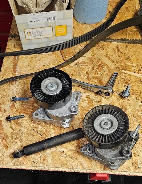

So, I am really confused at this point. We know the SRT belt tensioner is different from the N/A. The SRT6 one has the 10E torx, the N/A doesn't.
I cannot find the SRT Belt Tensioner ANYWHERE for the life of me, but I found the picture of the SRT engine, at the Chrysler museum (or at least some kind of display of the "original SRT" engine) and it looks to me like it has the N/A belt tensioner.
Can the SRT belt tensioner just be replaced with the N/A version? Or is there an upgraded one that looks the same? I need help finding this part. I do not have a larger Crank pulley, just a 65mm Supercharger pulley.
What's everyone's idea? I find it hard to believe that the unavailibility of the SRT6/SLK32AMG belt tensioner will send these cars to the junk yard.

The one in the picture is the SRT6 tensioner. The N/A has a torx screw on the front and the pulley is different.

Question for me is, a lot of places list SLK32AMG/C32 AMG and they look similar at least, to the N/A tensioner. Do they fit? They cost a fraction of the cost outlined above.
What happens if one of those is installed? I’m just thinking there has to be a replacement option for less? Could be totally wrong though.

Ok, silly question. Why wouldn't the N/A tensioner work on an SRT6 engine?
The mounting holes match up, I would think the pulley is the same size. The orientation looks the same.
Is it because the pulleys are made of different materials? Has this been tried?
I would think not because the tensioner has to take a lot more stress. I sure wouldn't if I owned an SRT-6, if it does explode down the line I wouldn't want to have to fix it (iffin I had one)...
