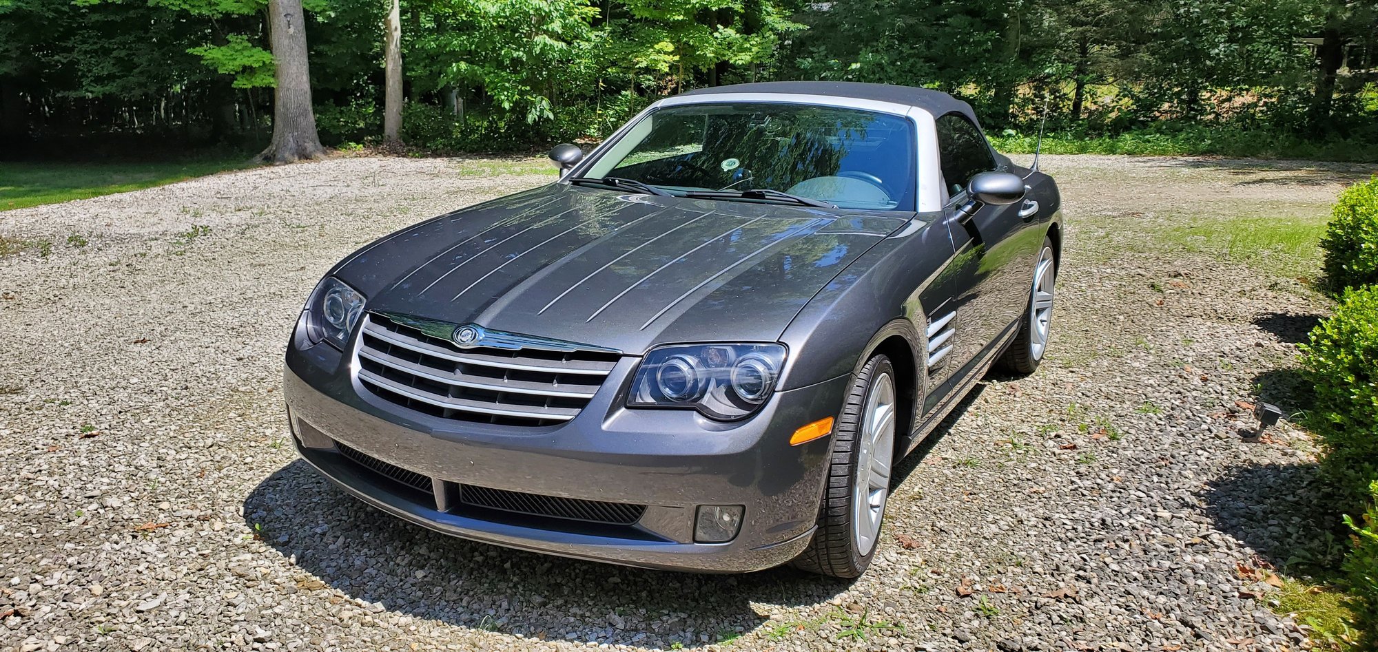

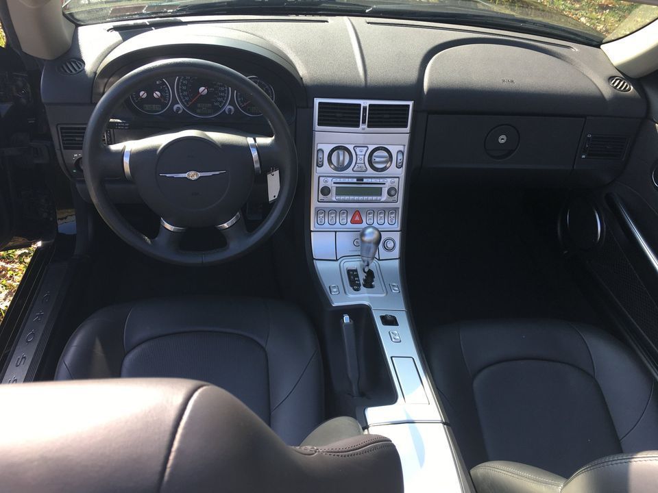

Default Re: Sticky Ignition Key Fix for all Crossfires 2004 thru 2006
Originally Posted by amx1397
what do you want for it id u do decide to sell it?
paid $13,500 yesterday
a bit much, but i LOVED IT
interior is flawless
convertible top is flawless
everything is amazing
brakes do need something
spongy, like the lines need to be bled
