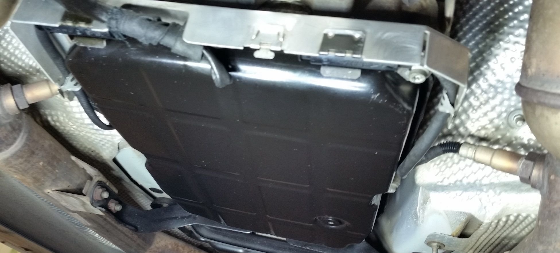

NAG1 / 722.6 / W5A330 5-speed automatic differences
We got the straight-up "for realz" Mercedes-Benz 722.6 tranny in the Crossfire, no different than in actual Mercedes' cars. I'll include a picture of my car's pan. Notice it's painted black and has a drain plug.
Here's a pan shot of a NAG1 / W5A330 in a 2006 Chrysler 300C SRT8. Notice the pan isn't painted nor is there a drain plug. Otherwise the pan "stamping" is identical such that you could swap the pan from our car to the Chrysler 300C and vice-versa.
https://media.carsandbids.com/cdn-cg...gvW07ymxL.jpeg --- 2006 Chrysler 300C SRT8 transmission pan (URL link)
I just found these slight differences interesting.
2005 Chrysler Crossfire 722.6 black painted pan with drain plug
