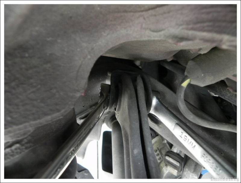

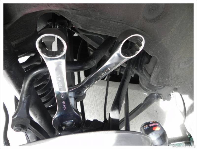

I understand you want a DIY post, but it is very easy. I found my best way to remove the inboard bolts was with two wrenches. When you remove the OEM arms, they will be 11¾" OC.

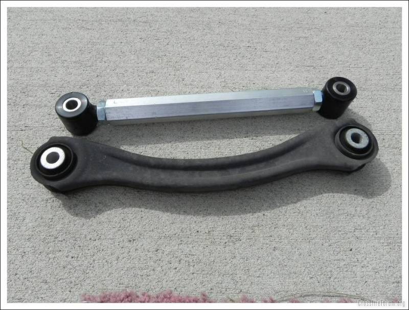

Before installing adjustable arms, take them apart and apply anti-seize compound on the threads. Reassemble and run both ends in until they bottom out. Then equally turn them out until you get 12" OC. I slightly tightened the lock nuts before assembling so I wouldn't accidently move the adjustment. Once tight on the car, I locked down the nuts with the ends parallel to each other.
Using the 12" OC measurement, at first I thought it was too much when I got the car off the stands. After I drove it around the block, the wheels look as I want them. Using a framing square to the driveway, the wheels are still slightly tilted in, but not noticable to the eye. I will leave it alone until I get an alignment one day.

I would make a DIY post, but then others would just want to tear holes in it. So with that, I will post the pics from when I did mine. Any more questions, just ask.

The OEM links are 11.3/4" centers. You can start by setting the adjustable links to 12" centers. The OEM links curve around the sway bar. The straight ones come awfull close but if you lower the car by 1" or less, it will be fine. The fact that it is straight makes it much stronger and rigid.
