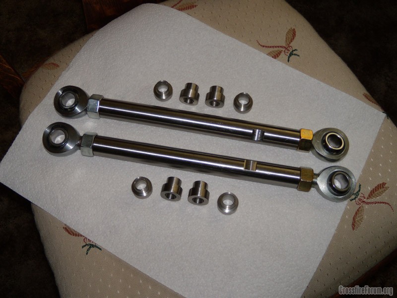

You could use these arms..... they are 7/8" stainless..... and priced at $195....
For camber arm install instructions see the attached .doc file.....
