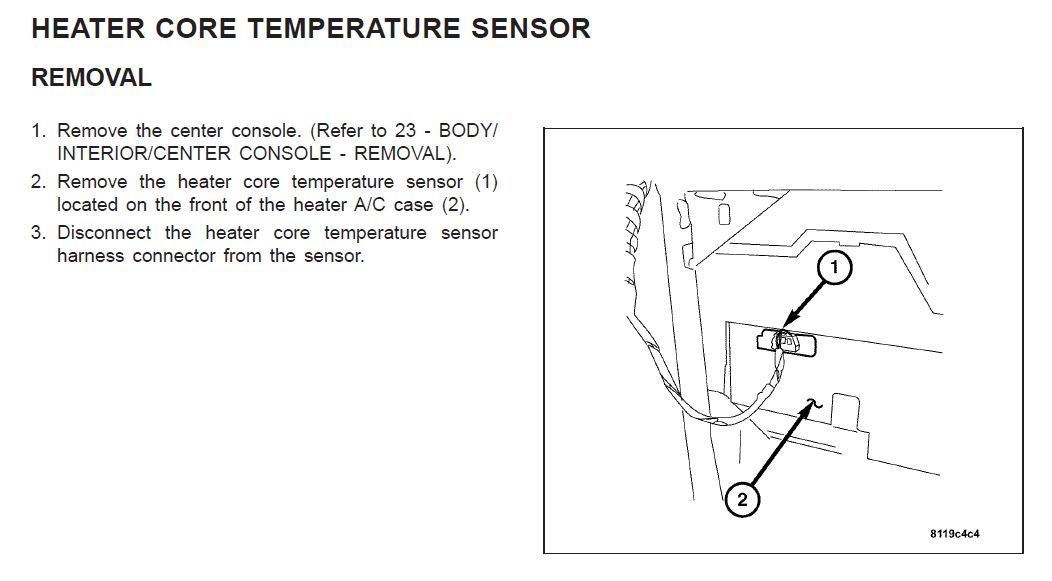

Recently I've face with heating problem: passenger heating working perfectly but drivers not working at all. I have unplug coolant circulation valves (see picture) and found some oxide on contacts. I've clean the oxide using contact cleaner and plug contactor back. For couple minutes driver side (as well as passenger) start working as it should work but then error repeated. Now again heating works only at passenger side. Also while air circulating fan is working sometimes it completely shut-off for couple minutes and then return to operation again (no matter what regime is selected heating or cooling). Can you please advice if problem in heater core temperature sensors or i should replace coolant circulation valves?

Guys, the sensors are on the heater core. There is one on each "side" and it senses how warm the air is that is flowing by in order to provide feedback to the climate control as to set the temperature of the air coming out the vents so that it (more or less) matches the setting on each ****. You can demonstrate this by settting the ***** at mid-point. Start a cold engine. As the engine warms, the duovalve will open less. The effect is, the air will rise with engine temp only to a certain point, after that, it stops rising as the feedback causes the duovalves to open less and less because the water is hotter.
There is no sensor, of course, telling the climate control what the temp in the cabin is, the system only regulates the temp of the air from the vents. I see no way for the BCM to know about window position, other than the BCM appears to know if hte windows are all the way up or all the way down. But there is no sensor to tell the BCM what the windows are doing, other than that. I don't have the manual near me, but I do think the Climate control is on the CAN BUS, I know the BCM is.

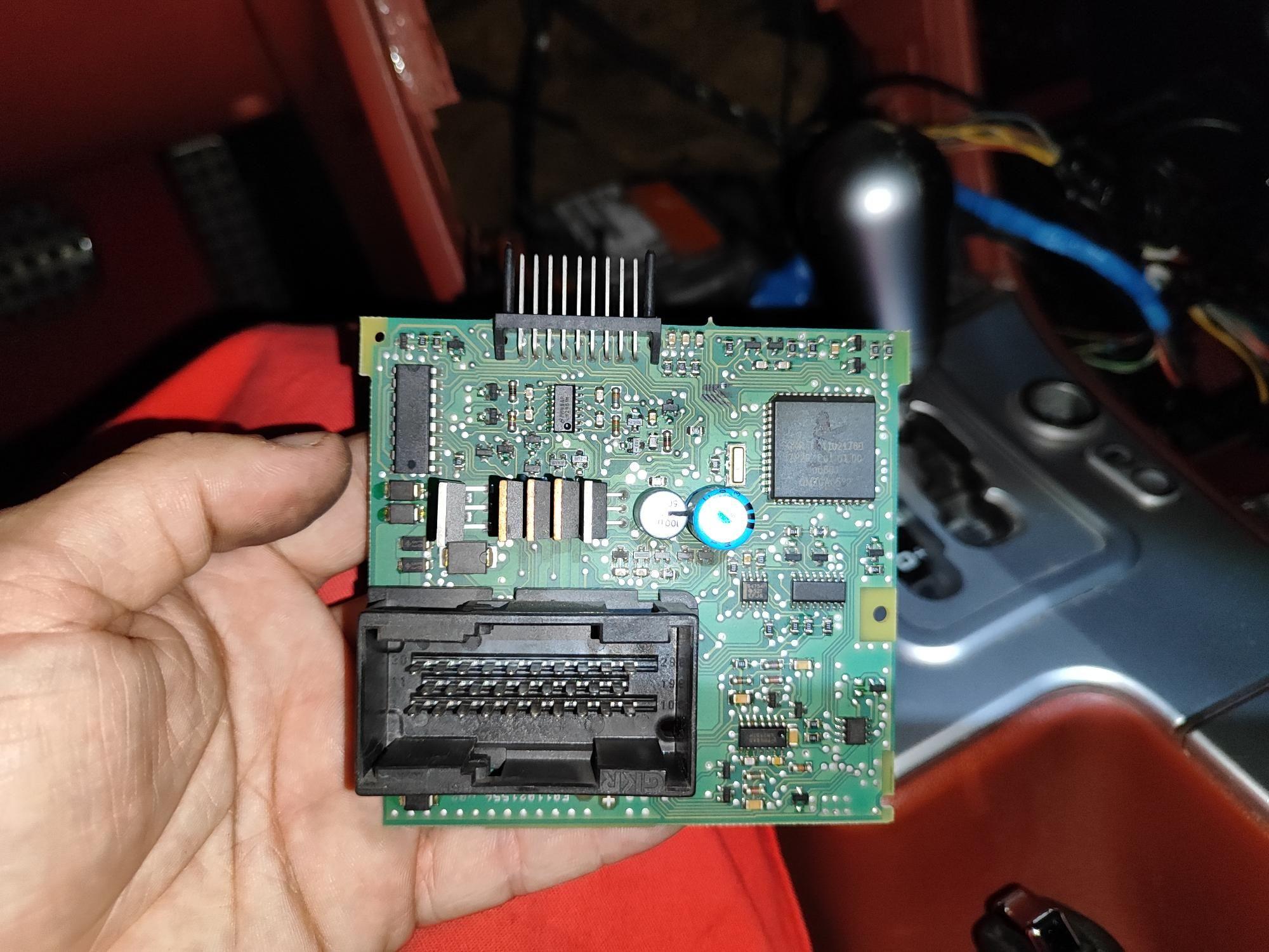

Yesterday i have tried this 20-30 minutes of "overclocking" - unfortunately no result. During test I have manually checked temperature of hot coolant supply tubes:
So supply tube was extremely hot as well as right (passenger) valve. However left (driver) valve was warm during entire 30 minute burn-out. Same for tubes connected to valves outlet which connected to heating radiators:
As you can see from above picture top tube (driver) was warm and bottom tube (passenger) was extremely hot. When I've stop heating and return temperature back to normal, bottom tube (passenger) cooled to warm condition. Next I 've disassembled HVAC unit and found nothing strange there:
I've even manage to increase contact between 2 circuit boards as it were described in "Climate Control Fan Speed Fix" .pdf file. Could you please let me know my next steps for problem solving?
Highly appreciate your support - thank you all
