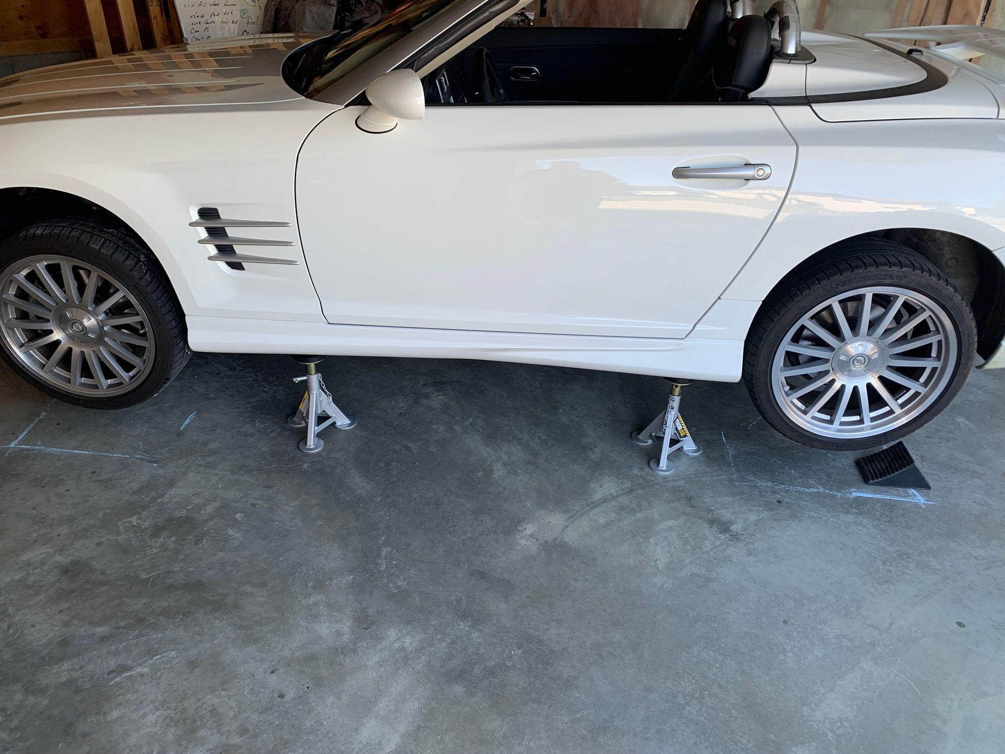

I jack it up from the cross member in front and the pumpkin in the rear
for the floor jacks, I have 2 styles. Both work with the jack pads. If you use the jack stands for the pinch weld, you may experience an issue.

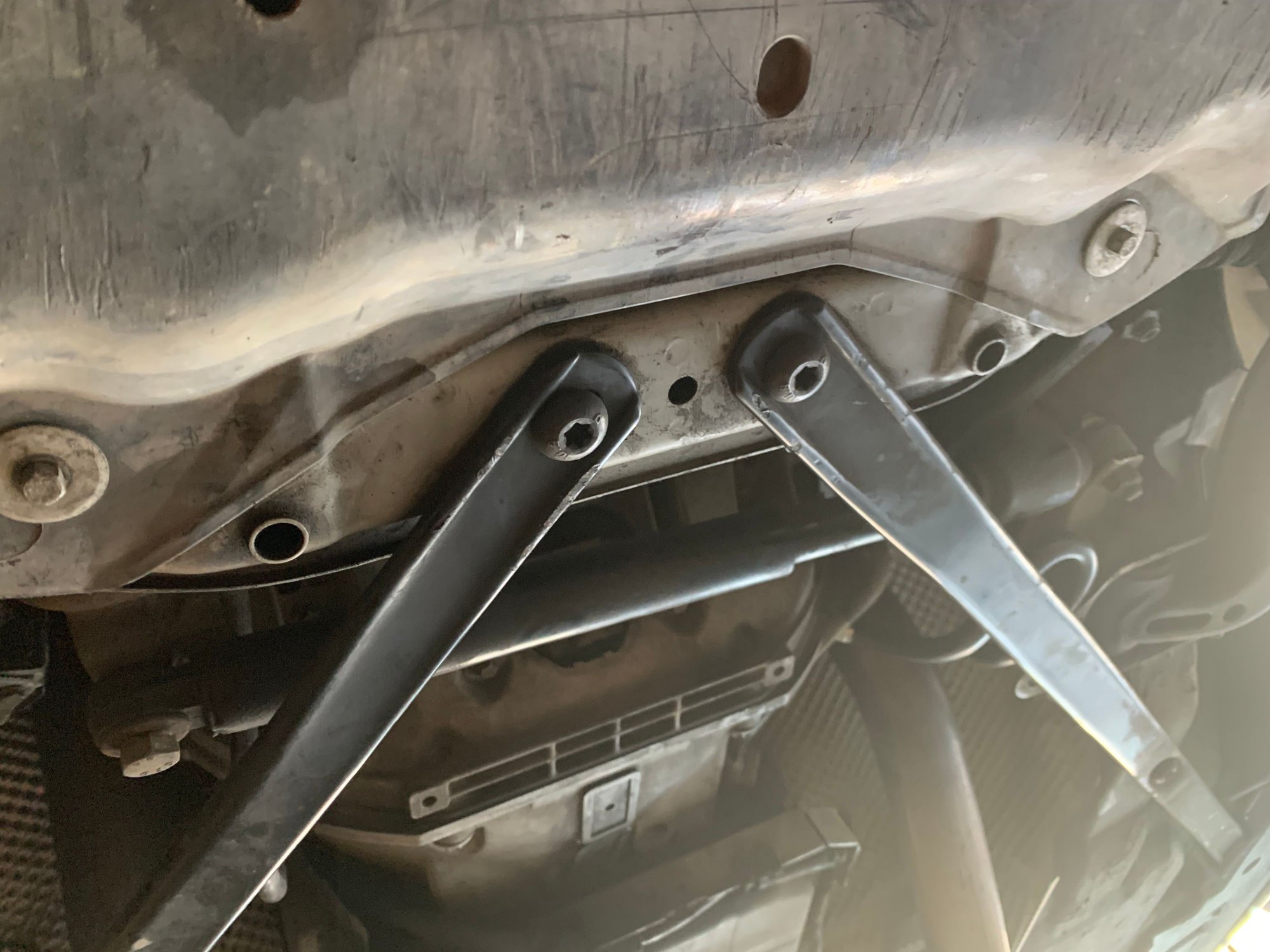

Thanks can you show a pic of where your place your jack on the front cross member?

right behind the splash shield
You will need a really low profile floor jack.
You may also need to drive the front wheels up onto a few 2x8 pieces in order to achieve clearance for the jack
I’ve lowered my car so I need to do that. I also use a thick rubber pad between the jack and crossmember.
hope this helps you out.
