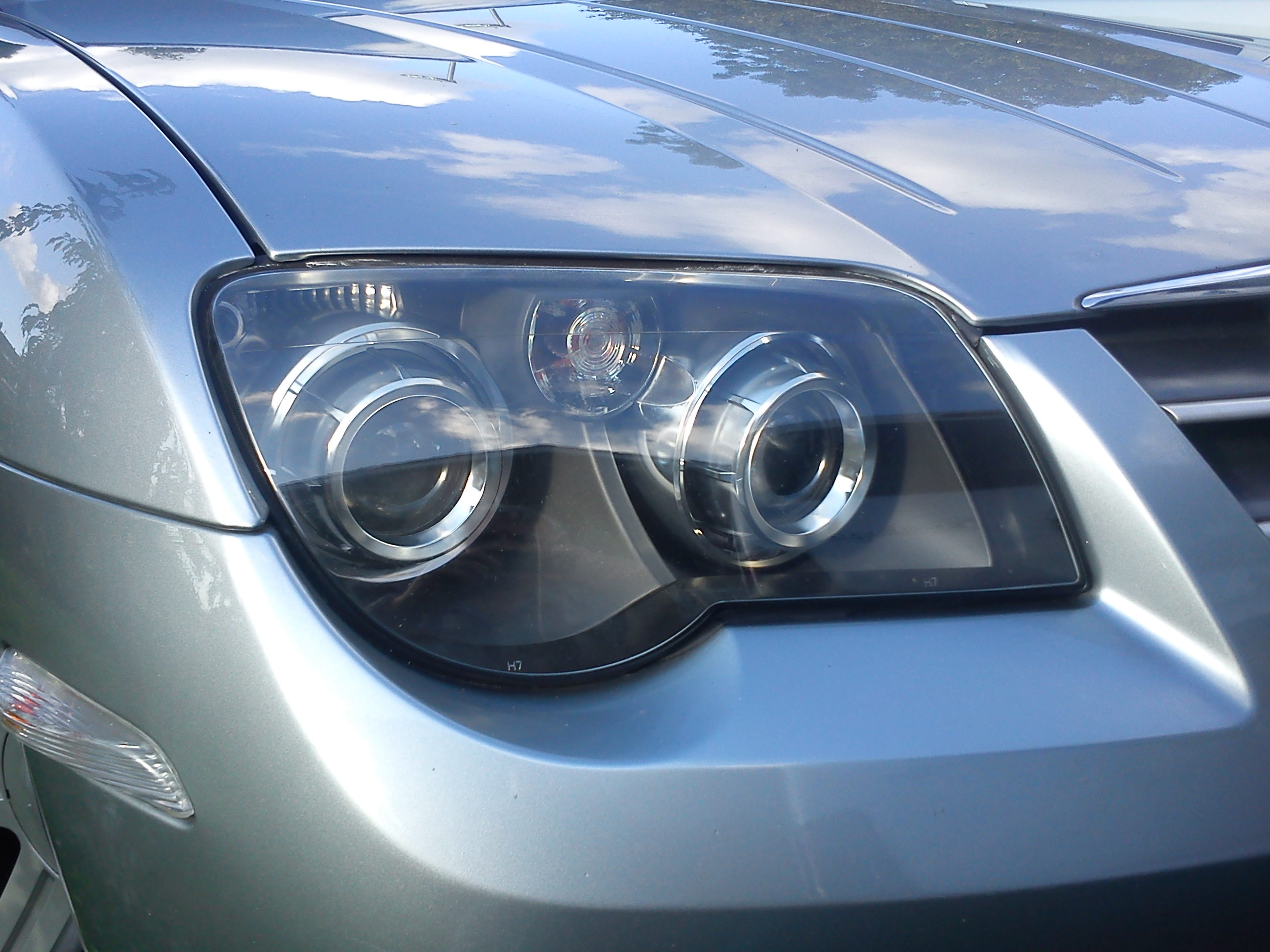

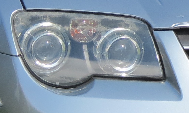

This is from one of my old posts
Hard work & Meguiar's Plast rx
https://www.crossfireforum.org/forum...off-before.jpg
https://www.crossfireforum.org/forum...-off-after.jpg
Hopefully you can click old links

i got mine done a while back by a local body shop guy that i know, he sands them down then 2 coats of clear lacquer look lik new charged me £35
before
and after
