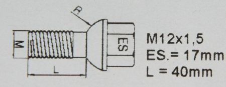

The locking studs were extra, although some dealers add them from the get go these days.
These are the specifications for size
on the OEM studs. ES is the across flats dimension.
Note the radius (R) seat, they are not tapered seats.
I think the L dimension could be 38mm (1.5")
I have the box for my set in my hand but the label is torn away and I cannot read the number. I got mine from a Chrysler dealer and they were not too expensive, but still they would be cheaper elsewhere.
From the Crossfire Master Parts list.
Lug bolt locks, set of four
MB #Q6408113
DC #82208313
