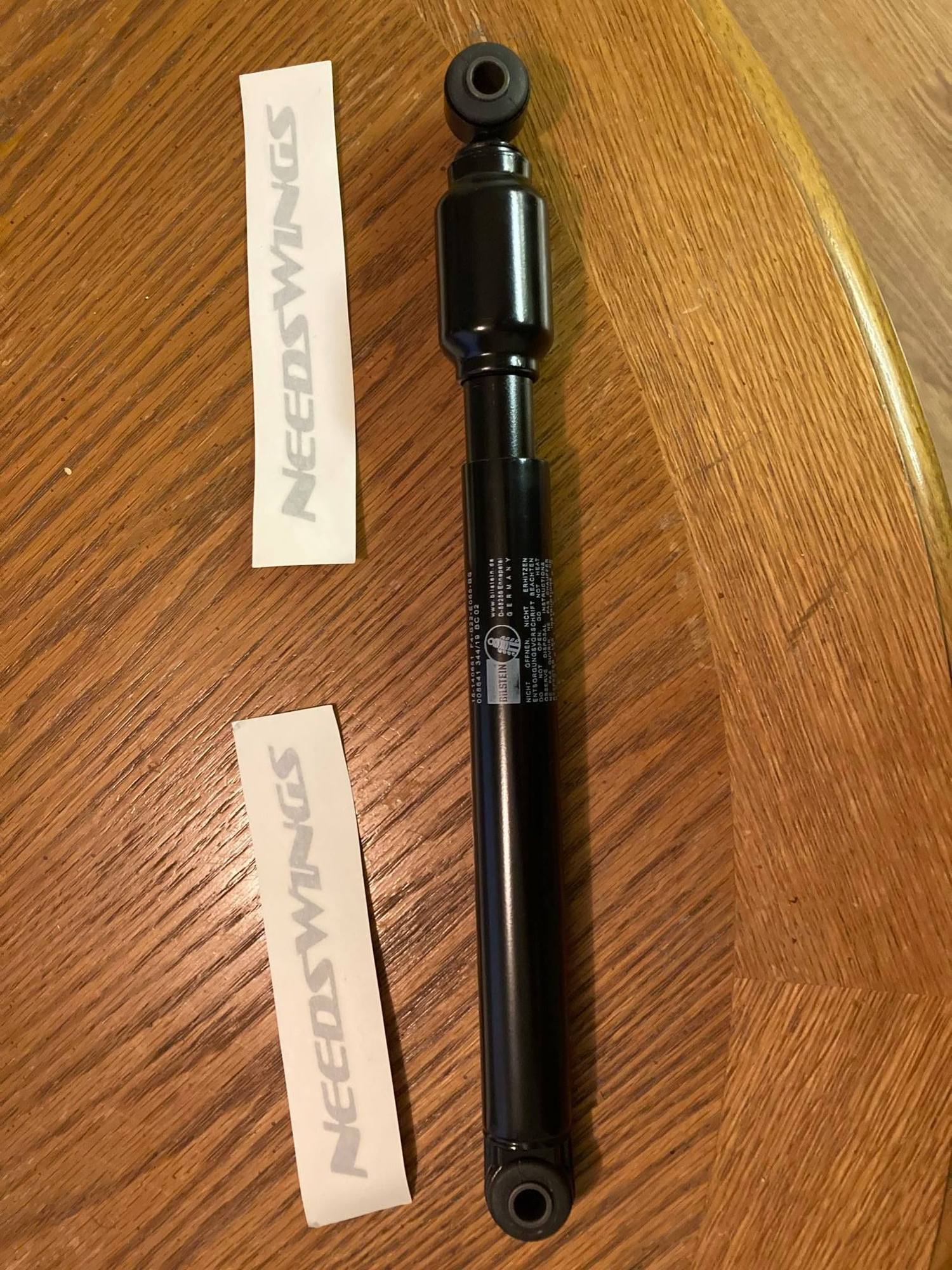

Old Nov 1, 2020 | 10:36 AM
  #552 (permalink)
Posts: 13,959
Likes: 1,288
Default Re: Replace your Steering Stabilizer, you'll be surprised.
Originally Posted by Coyote
When I am looking for parts such as that, I always check Needs Wings first. They list this stabilizer in this section of their website: NeedsWings Performance Products. Suspension SRT6
Good luck,
Same here. I ordered mine from Rob. It was an OEM part, the one on the car and the replacement were identical - tho after 13 years and 54,000 miles, the original was certainly bad.
The steering wheel is firm now, and handling is way better.
Old Nov 1, 2020 | 10:45 AM
  #553 (permalink)
Posts: 13,959
Likes: 1,288
Originally Posted by Ronman
Who is the manufacturer of the stabilizer you put on?
I did not give it a thought, I trust Rob to sell OEM or OEM equivilent parts.
Fortunately, I have OCrossfireD and snapped a picture of it - it says Bilstein on it.
See post 541, Rob's price is way lower than FCP, I paid $40 or $43 or whatever it was.

Old Nov 5, 2020 | 12:25 PM
  #555 (permalink)
g3air's Avatar
Posts: 106
From: Punta Gorda, FL
Got the Rhino Ramps for $38.49 at Home Depot and got the recommended stabilizer from FCP EURO for $50.93 delivered. Had the 16mm socket and wrench. The ramps slipped on my smooth garage floor but worked well on my driveway, especially since they were on a slight downward slope. And I was able to turn the wheel slightly to the left without moving the ramps. I did not add any fresh blue loctite to the upward facing bolt (think there was enough residual there). The original part has equal resistance to the new part, so I likely did not need the replacement (at least not yet). An easy task to be sure. I will keep the old part and use it as a contingency replacement should the new one ever fail.
Thanks for all the advice.
