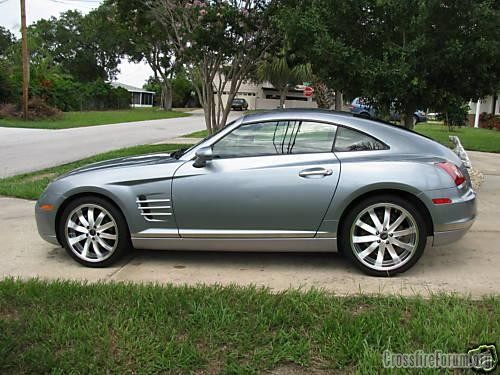

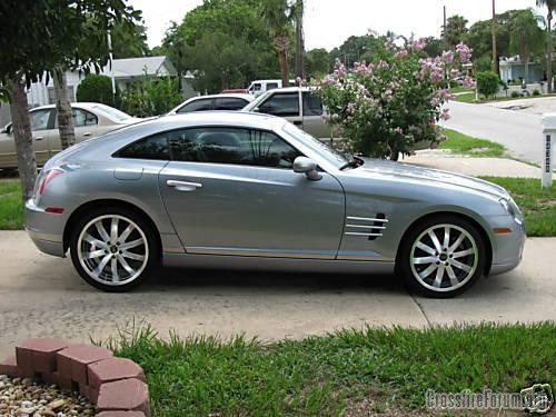

You'll probably need the following ADR Propulsion Rims:
Front: 18 x 8, 5 x 112, 33 mm Offset, 73 mm Hub Bore
Rear: 19 x 8.5, 5 x 112, 20 mm Offset, 73 mm Hub Bore
Hub Centric Rings: 66.56 mm / 73.0 mm
These ought to fit w/o much fuss with factory size tires mounted. nox1s can chime in to verify.
Here's an eBay link that has these wheels listed in various sizes & styles. Worth seeing the different looks.
Attached are pictures of a 2004 SSB coupe in Florida that I passed on that had these rims mounted. Absolutely Gorgeous!! I should have bought this car!!

Thanx for the additional info.
I got a rim/tire place close to me that could have gotten me the Mandrus Millemium's, I'm gonna check with him on these ADR's.
If he can get them within reasonable price of what's found on the web, (adjusted for ship and mount), I would prefer to give the local guy the business.
Also if I run into any issues he's close by, and it's one throat to choke.
The pix on the Xfire you passed on, look to be the Hybrid-Silver finish, and work real nice with the SSB color scheme...
