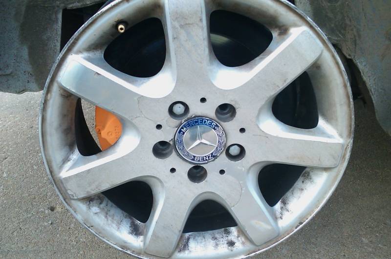

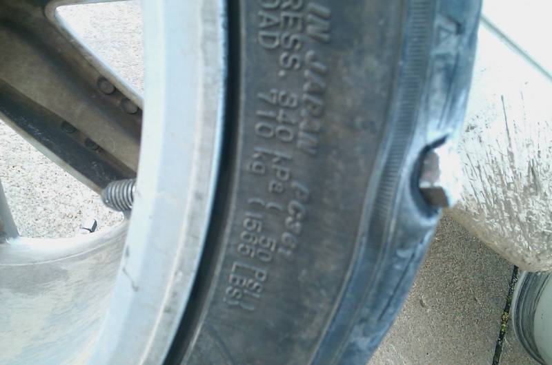

Do a Google search for slk 320 spare tire. Pick out any salvage yard (junk yard) thats listed & see if they have a donut spare
available for a M B slk 320. I bought mine years ago. It was from a 2002 totaled car. Spare had never been used & worked
well on trial inflating & deflating. Our factory lug nuts fit perfectly & so does the donut tire both on the front & rear wheels.
No clearance problems anywhere. I bought a little travel trailer spare tire cover for mine in gray & you hardly notice it
when it's stored in my trunk. It does not take up that much room & serves me well for the peace of mind wherever I am.
Not sure if it would clear an SRT suspension setup but it's just right for an N/A. If I remember right it cost $125.00 incl. frt.
from California.

Would a spare from an SLK 230 be the same? I assume it would, but one never knows.
Old May 24, 2012 | 12:13 PM
+fireamx's Avatar
Posts: 7,509
From: Akron, Ohio
Default Re: Spare tire
I can't say for sure what size spare the SLK230 has, but I'm going to assume the diameter of it's tires are probably close to those of an SLK320.
The SLK320 uses a 205/55R16 in front, and a 225/50ZR in the back. The rear tire of the Mercedes must have the same diameter as the "stock" rear tire that comes on the Crossfire, because according to Motor Trend Magazines Dec. 2003 Comparison road test of the two cars, they are turning exactly the same RPM when going the same speed. (Probably because they use the same 3.27:1 differential, and transmission). Even though the spares diameter is smaller than that of the regular tires, it must not be small enough to play havoc with the cars computer.
I've been telling people to use the SLK spare ever since I've been on this forum, and I haven't heard of anybody having problems with their EMS shutting their cars down.
Yep.. they fit.. At least I can vouch for the rear location.
