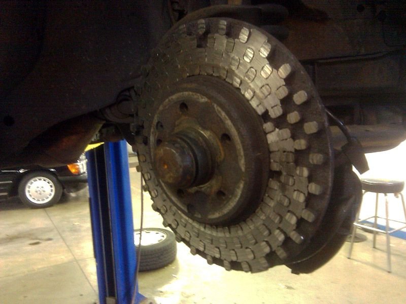

Fix the problem before it looks like this.
WOW!
I've never seen that before!
That's a first for me. I've never seen a catastrophic failure like the above!
